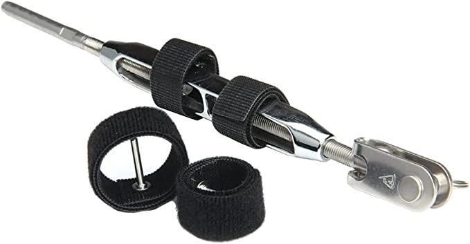

There is no need for those covers other than possible cotter pin chafe prevention and ankle scrape protection. I got rid of mine at least a decade ago. No regrets. They were falling apart and hid the turnbuckles from easy visual inspection.
As for cotter rings on turnbuckles, except for trailer sailing, I don’t recommend them. When I first got rid of my covers, I tried cotter rings for a couple years and was unnerved when I saw how easily they can bend out of shape, and not just by snagging on a line. If a turnbuckle unwinds a quarter or half turn under load, it can mangle, potentially even sheer off, a cotter ring. I switched back to traditional cotter pins, heaviest gage that will fit, with a few wraps of rigging tape to protect feet and ankles.

Picture of wrap pins please.
Circular rings can and will be snagged
as I have been nailed by them to include sails.
Yes you can tape the cotter pins and circular but if the last wrap of any tape is too tight it will unwrap itself. Also never tape over the bottoms of the turnbuckle whhich can trap water which will cause corrosion damage to the studs and threads.
Yes boot covers help keeping salt water off most of the time
It is highly recommended to inspect the turnbuckles every time you get on a trailerable sailboat
