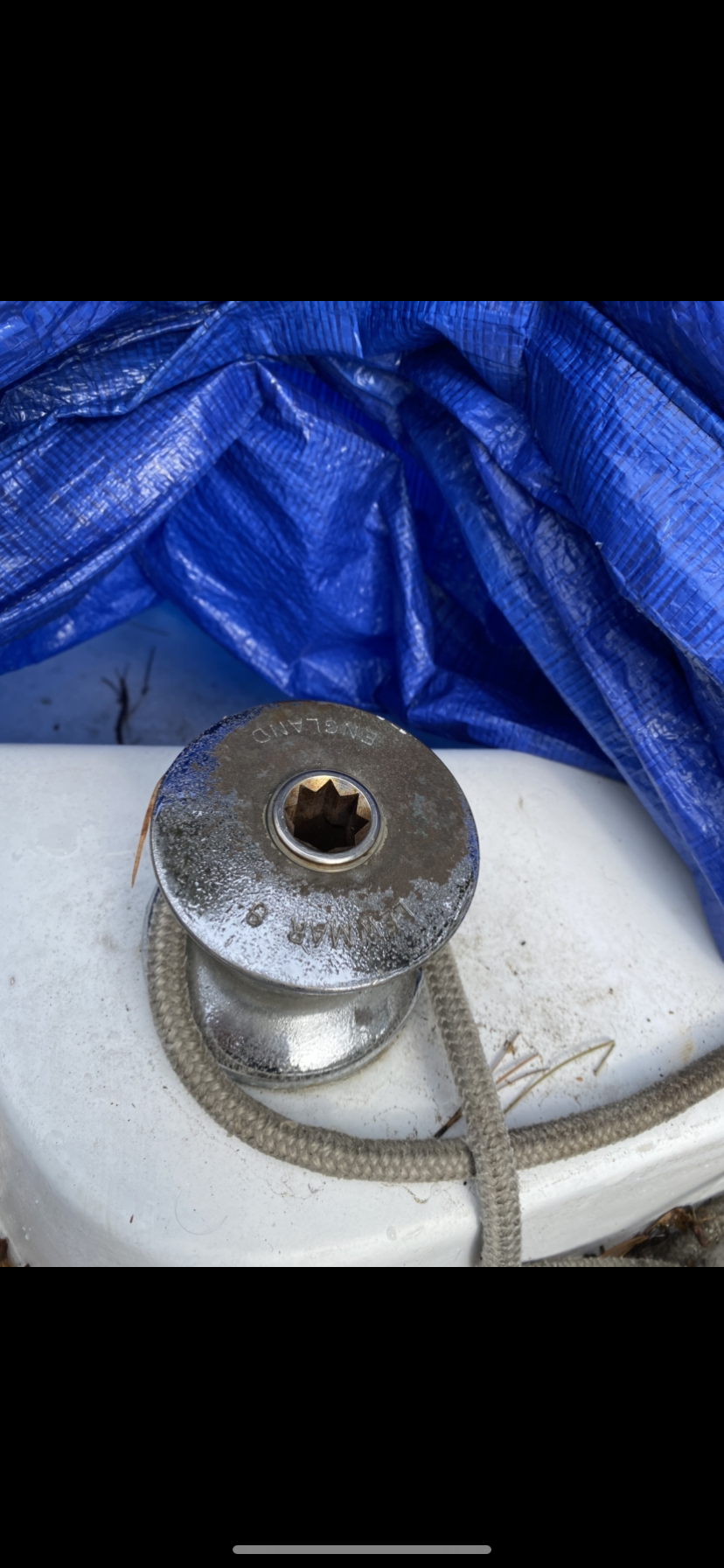

Dear Fellow Sailors:
Any suggestions on correcting the esthetics of my winches? Paint, prep etc
The least expensive way would likely just be to remove the flaking chrome coating and just let the winches be bronze... That will look real old school... LOL (Your winches will wear out faster)

The least expensive way to make your winches look presentable is to remove the chrome entirely. You'll be left with a bronze finish. Make sure you use personal protection and have adequate ventilation.
1.Remove all internal winch parts such as gears, bearings, pawls and springs.
2. Mix 1/3 part hydrochloric acid to 1 part water in a vat used for chemical mixtures (like a heavy-duty plastic bucket, etc.) to produce a 30% acid solution. ...
3. Submerge the chrome-plated winch in the solution until chrome strips off.
4. Wash the winch thoroughly in soap and water, and rinse before drying.

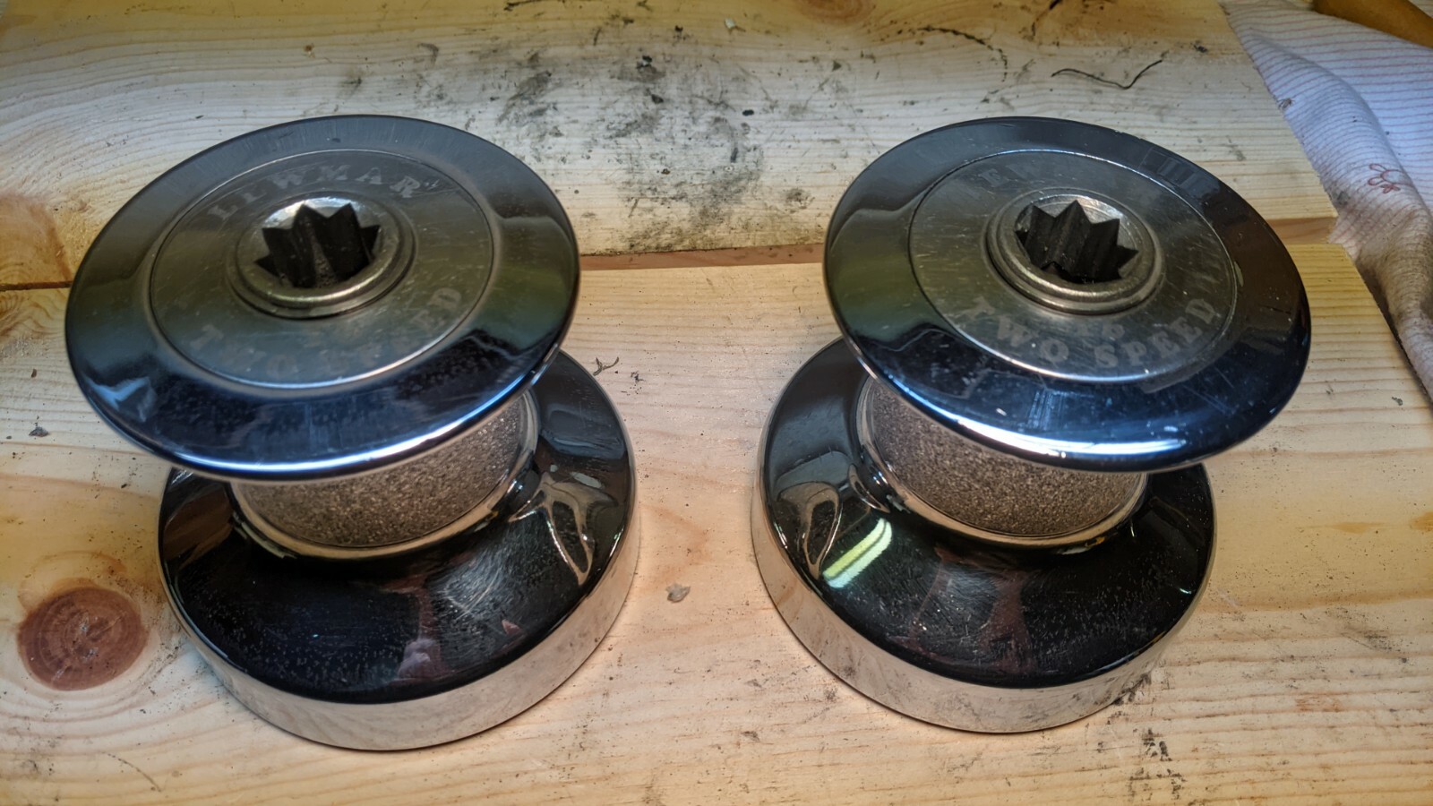

You'd need a powder coating bath long enough to have your boom fit. They do have them, one of the things that often gets powder coated are guard rails, so there are long baths. Not sure if you'll find one to handle a mast, but should be able to find one long enough to do a boom.
The temperature and electrostatic charge are fundamental to first steps of being able to be powder coated, but then you also have adhesion to the substrate. In the case of steel and aluminum those are the bread and butter base metals for powder coaters.
Bronzes are a bit more complex. You'd have to know the specific alloy and have a surface preparation method developed for that alloy or the long term viability of the coating could be compromised. The second problem is is that the rough surface used for friction where your line wraps will be pretty much obliterated by powder coating. That's quite a thick coating and would really smooth that area out quite a lot.

I agree with all points Dave. IF I was doing winches I'd hope to not do the rope drums, just the tops and bottoms, leaving the rope drums bronze.
