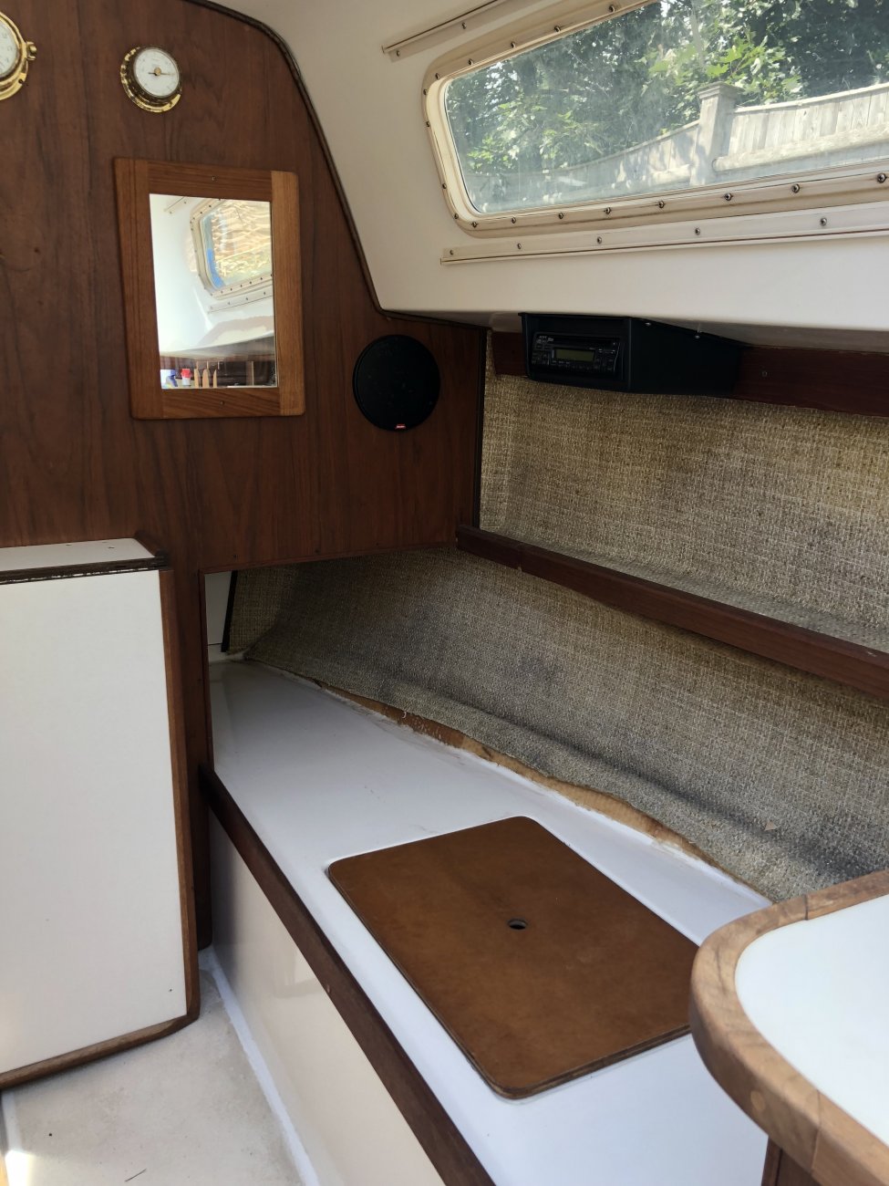

Hello All,
We are continuing to restore this 1978 Hunter Sailboat for use as a guest house in our backyard. We are interested in installing a new headliner this spring (see link below).
I am wondering if anyone has used it before? Any tips for removing old headliner (see pics)? Any tips for installing new headliner? What's the best adhesive to use? Any tips for how best to finish/terminate it? Any experience with keeping it clean?

The head liner is fiberglass/gelcoat. Did you mean hull liner?
If so, I can't speak to the product you cited but... I did replace my hull liner 4 years ago.
The key to success is proper preparation.
Peel off the old liner, scrape the remaining glue/fuzz residue as much as possible.
Use a vacuum often and wear a mask, especially during the next step.
Sand the walls with 60 grit paper and clean with old rags and alcohol.
Then clean again with acetone on clean cloths. Change cloth often.
I used 3M spray adhesive and followed the directions on can or you can look at video instructions on "Sailrite.com" web site here:
https://www.sailrite.com/How-to-Install-Foam-Backed-Headliner-Video
Have fun!.

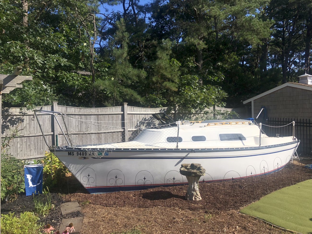

I showed my wife the picture before she or I saw the text. She guessed it way before I did! Smart lady.
Very clever idea.
What plans to do you have to get it rocking a bit like at anchor, and do you have a stereo that can emulate the sounds of gently rushing water? :)
airBnB or H20bnb?
Aug 14, 2018
9
Hunter 25 Cape Cod
