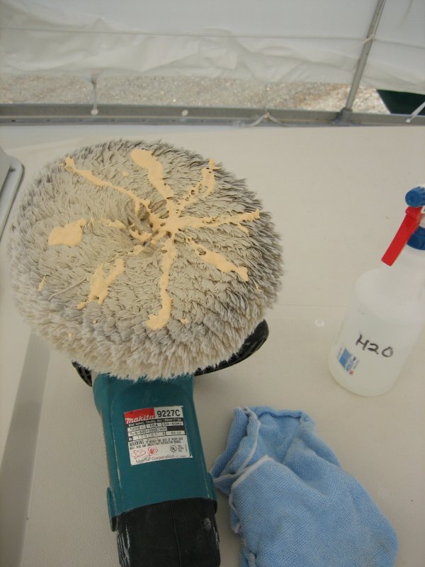

When compounding do keep in mind that a compound is like liquid wet sand paper. Therefore, you should keep your pad damp at all times. I use a misting bottle filled with water for this but don't over do it. If you are getting lots of small dot "sling" the pad is to wet. If you are a novice I do not advise attempting to use the buffer to "dry buff" or to "buff off" compounds or polishes. Running the pad dry, as in buffing until the compound is off the hull, is something best left for PROFESSIONALS or until you have the confidence and skill to go there. You can very easily damage your hull if you are not experienced at "dry" buffing. I've seen burned and permanently discolored gel coat from novices attempting this. This is part of the reason they put Silicone's in compounds and it's because most people don't understand the concept of how to use a buffer.
As a beginner your buffer should be considered just that a buffer and not a "remover". Work a 2 foot by 2 foot area first going at a slow speed 600 then slowly up to 1000 for 30-45 seconds then turn the dial up to 2k+ but below 3k and stop before it is dry. Next wipe the residue off while it's still in the "damp haze" mode. Don't let it dry or it will be a bear to remove unless you wet it again.. This will show you how much more you need to do or if you can move onto the next 2X2 area. ALWAYS, ALWAYS keep the pad and machine moving!!!
Apply compound in a criss-cross not a circle (note the mist bottle of water):

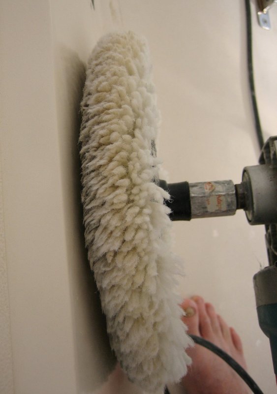

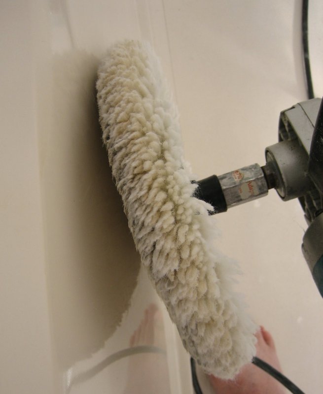

Edging the pad is for pro's or after you get comfortable with the process & machine !!
Right Way - keep it FLAT..

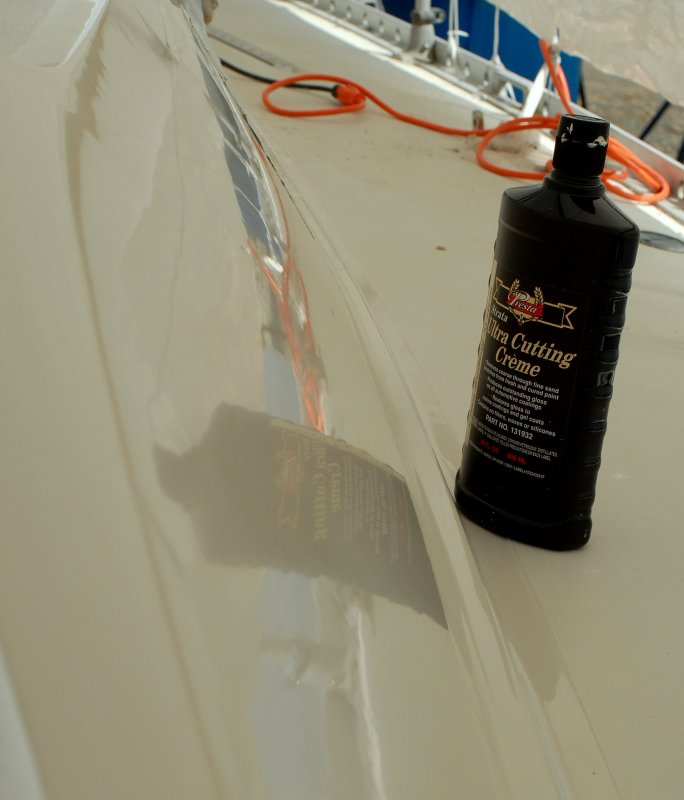

After compounding phase only using Presta Ultra Cutting Creme (no sanding was done here 30 year old gelcoat):

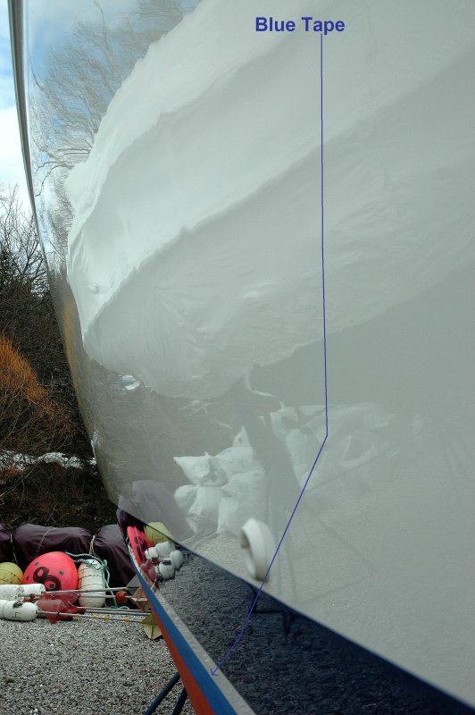

When buffing & waxing a boat, out of the water, a good trick is to cover the bottom paint with at least 2" blue tape so you don't accidentally buff and wax the bottom paint. It's important to tape neatly so you get wax as close to the bottom paint as you can without actually getting it on the bottom paint. I usually do a 3/4-inch width tape followed by a 2-inch width giving me plenty of tape to save my buffing pads. Fouling of your buffing pad, with bottom paint, is the end of that pad until you can wash it in a commercial washing machine. To keep "sling", what happens when you use a rotary buffer, and it throws white dots of compound up onto your deck, off the decks, I bring old card board boxes to the boat yard. Lay them on the deck directly above the area you're working protruding about 12" over the edge of the deck. The cardboard overhang will catch any "sling" on the way up and it will save you huge amounts of time cleaning white dots off the surface of your deck!
Blue Tape:

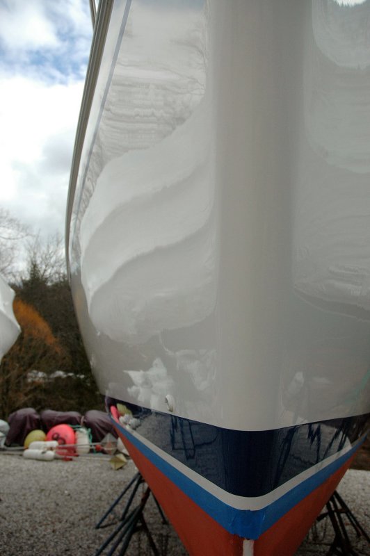

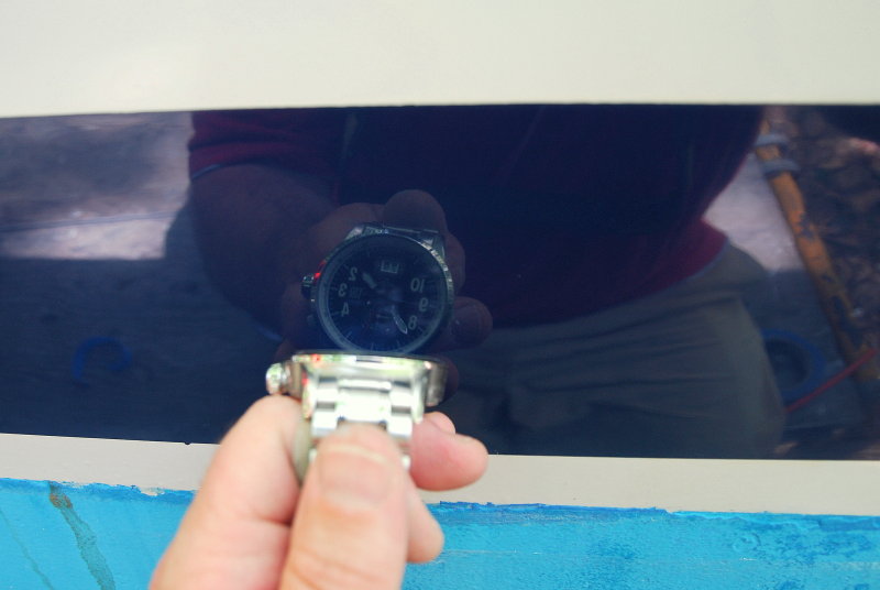

One insider secret is that less distortion in the reflection shows a very good polish/glaze with virtually no swirl marks. If the items in a reflection, such as a ladder, seems distorted the polishing is not up to par. You can also hold a ruler at 90 degrees to the surface and see how far you can read it. The further you can read the numbers the smoother the surface. Here I used my watch.

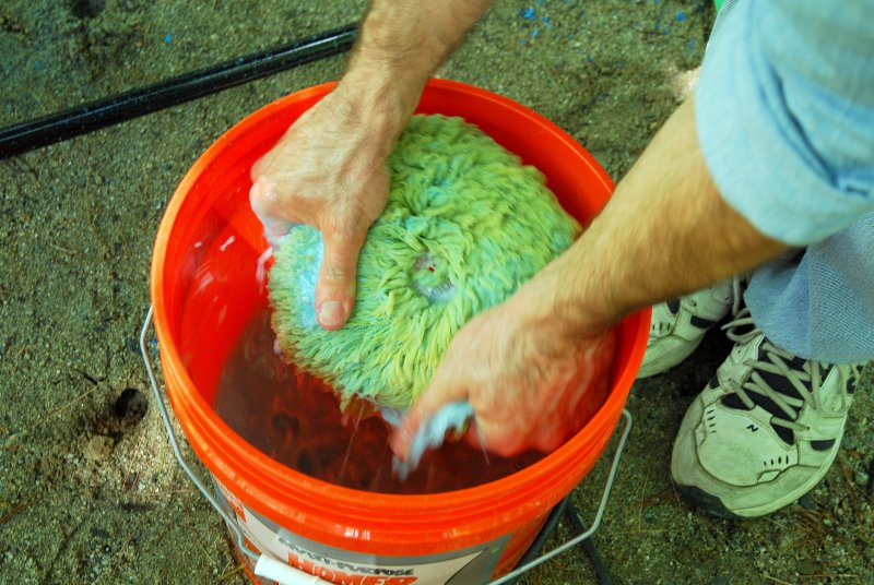

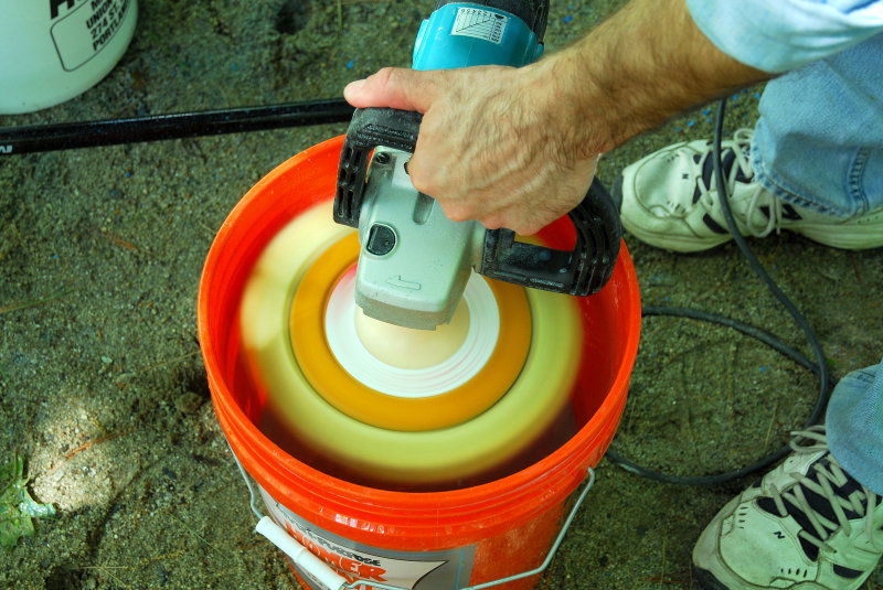

As for maintaining the wool buffing pads I wash them alone on COLD with Woolite in a home front load washing machine. Sometimes it may take two cycles to get them clean. Please do not dry them in a dryer and don't wash them on hot. They are wool and a hot wash or dry will literally change the pad grade. A polish grade pad can become a compound pad fairly quickly so wash cold then air dry. I rarely have to clean a pad, during a buffing project, unless I'm doing a boat that is badly oxidized. Use slow speeds and light pressure to prevent compound burning. You can also use a mist bottle of water, very sparingly, to give a little moisture to the hull and lube the pad. This however will create more sling so you’re best to go slow and keep the compound wetter. The secret is to keep the pad "damp" if it dries, it burns, and you'll need a "spur wheel" or spigot wash to field clean it. Spurs are available at an autobody supply shop or auto parts store but I really, really dislike them and find there is not much need for one at all.
A trick I use for a "field clean" of the pads is to remove the pad from the buffer and rinse it under a boatyard spigot scrubbing it with my fingers until it's clean or in a 5 gallon bucket filled about 1/3 with fresh clean water. I then re-install the pad on the buffer and spin it on the buffers highest speed inside a 5-gallon bucket to catch the sling. Spin it until no more water spins off on the inside of the bucket. Once done with that use a towel to get it as close to dry as possible. This is the method I use as I feel it's much more thorough than a spur and does not make your pad black from metallic residue. With water based compounds a "field clean" is very easy!!
Field Clean - Wash:
Field Clean - Spin Dry:
