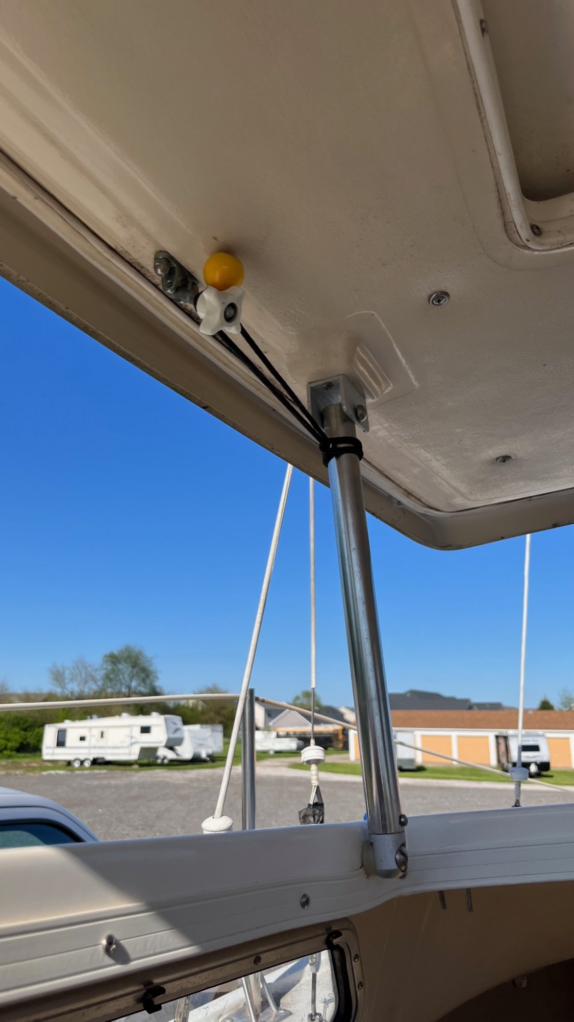

I have ordered the hydraulic lift kit but haven't had a chance to install it yet. It is supposed to really help with lifting it and slowing down it's fall.
My clip for holding the top up (the one in the mast) has held mine up pretty well, so you may need to replace the large set screw if that isn't holding it.
As for keeping the clips out of the way when dropping the top, here's what I've done:
It is a little bungie with a ball on the end. My boat had about a dozen of them from the prior owner. I just wrap it around the post and the knob and it holds it up and out of the way. I leave those on anytime it is up. The other alternative is to get some small clips that screw in just outside of the knobs, between the knob and the center of the top. I've been meaning to order a pair of those. It would make it easier because when you're done unscrewing them, they would just clip out of the way.

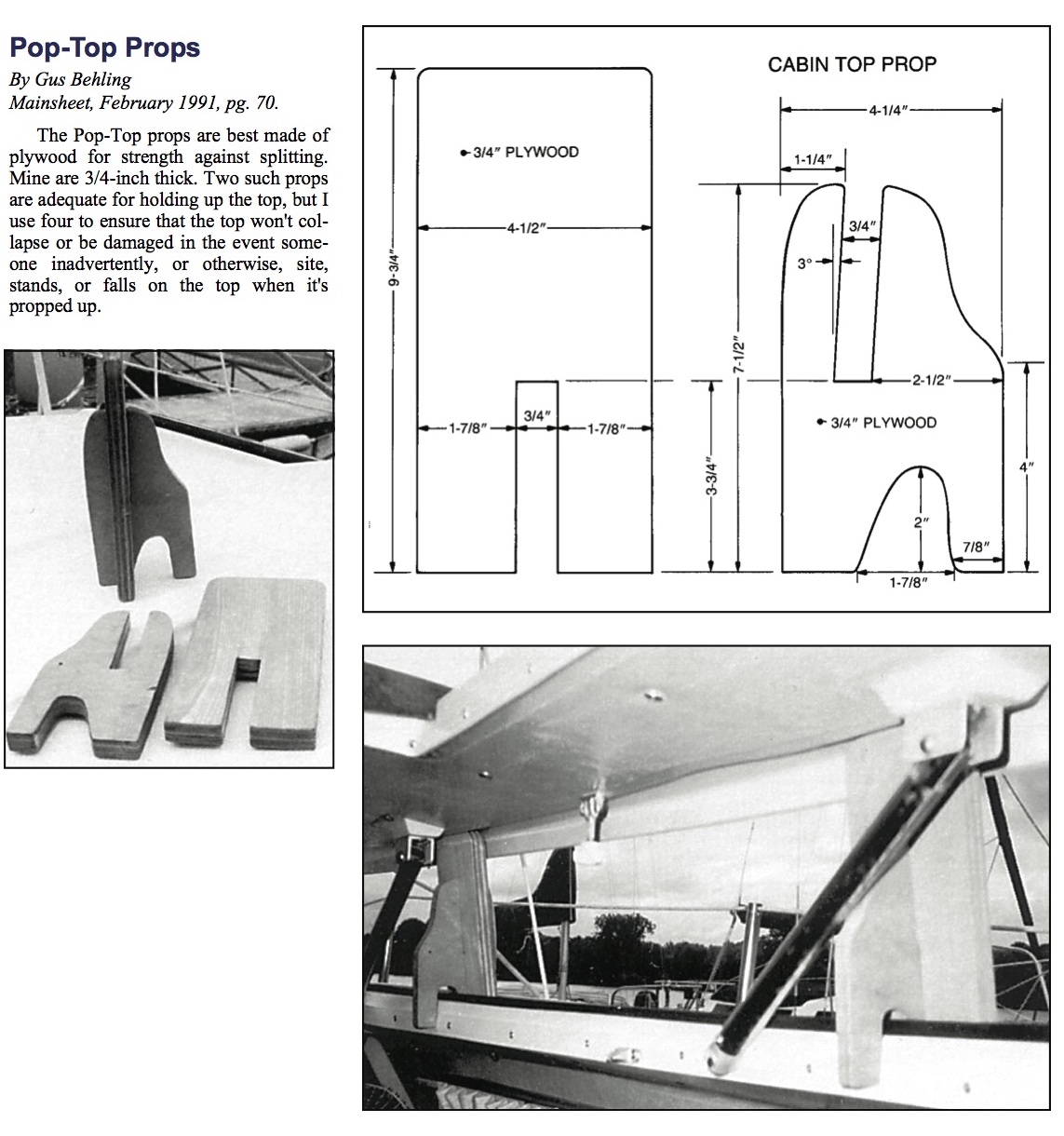

Sounds like you poptop lock is not in good shape. You should be able to tighten the knob enough,to not allow the.top to drop in normal use. That said, they won't prevent it from.dropping if someone falls against the top. That is why some people make removable, rigid supports as a safety measure.
They have the added function of holding up the poptop when the mast is down.
Great if you use the boat as an RV when towing it long distances.

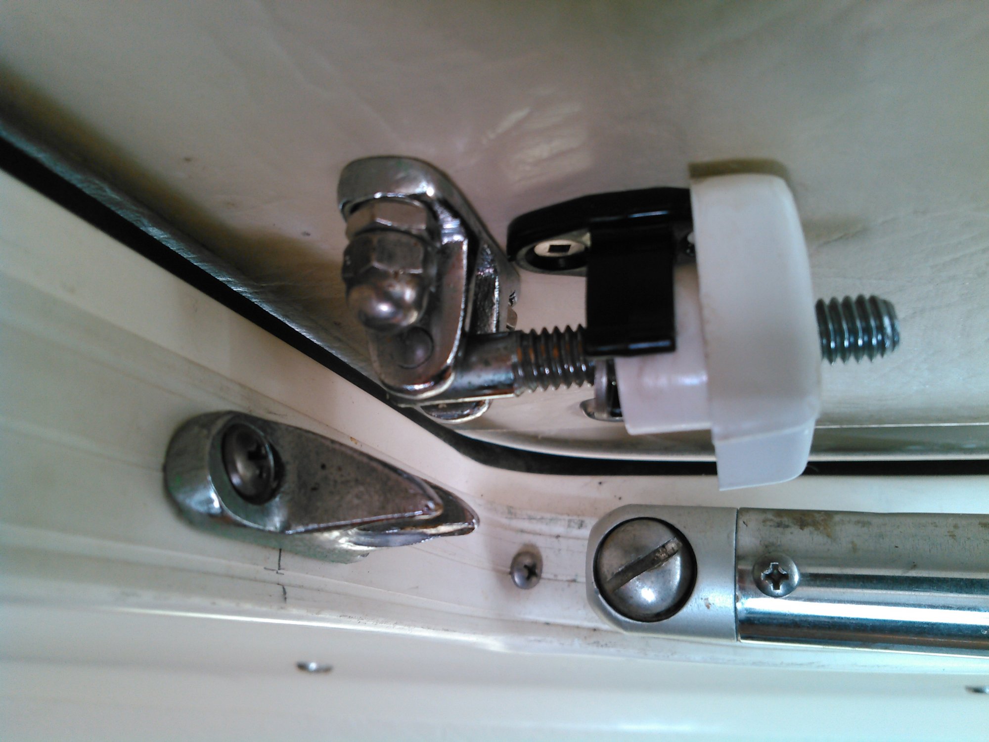

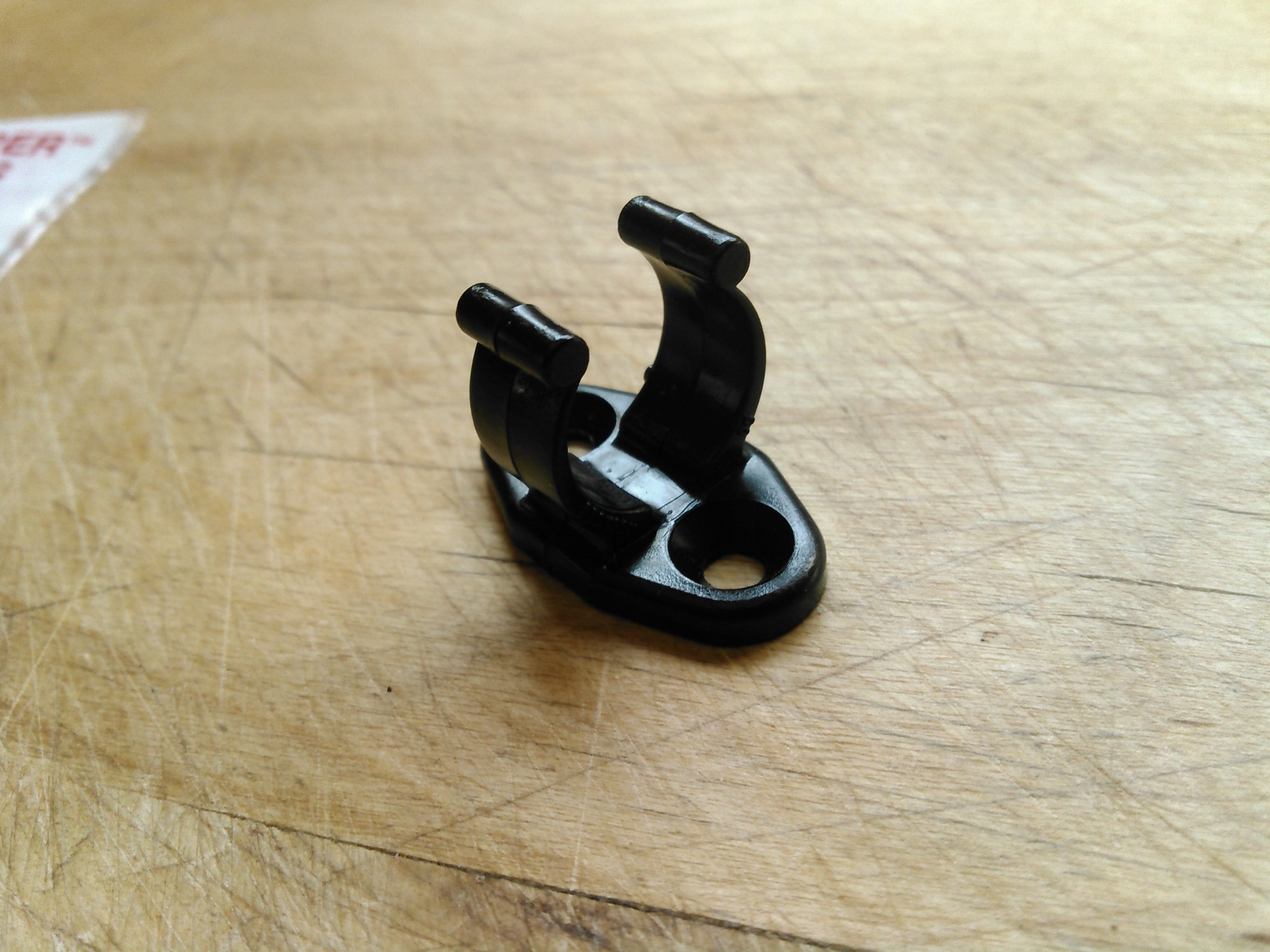

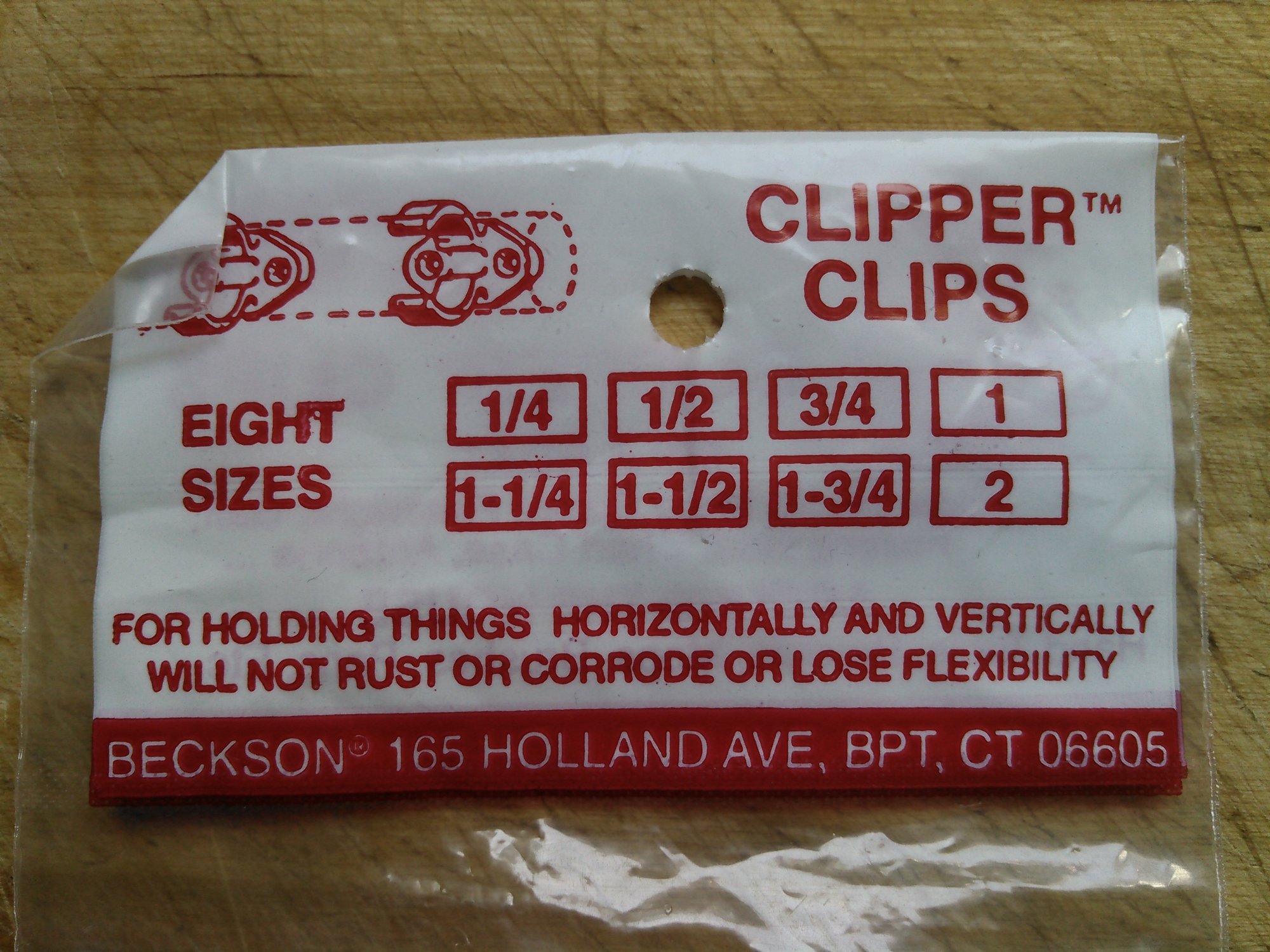

To keep the clamps/latches out of the way when raising or.lowering the top, get some Beckson Holding Clips.
Beckson Beckson Clipper Clips
They are just the right size to fit around the barrel of the poptop latch knobs, and hold them up, out of the way. (I don't remember the size I used. You will have to measure the knobs and order accordingly)
