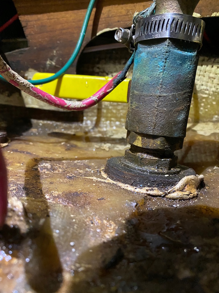

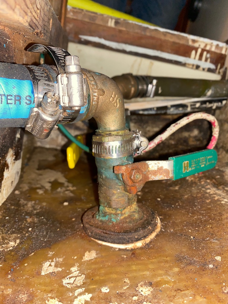

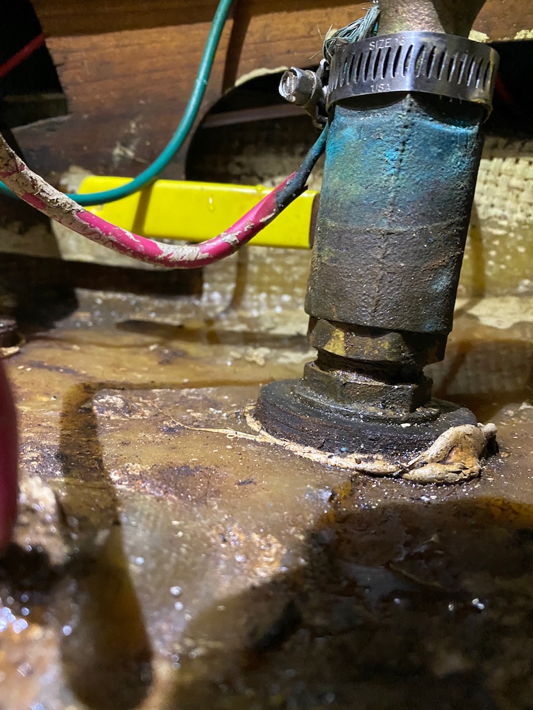

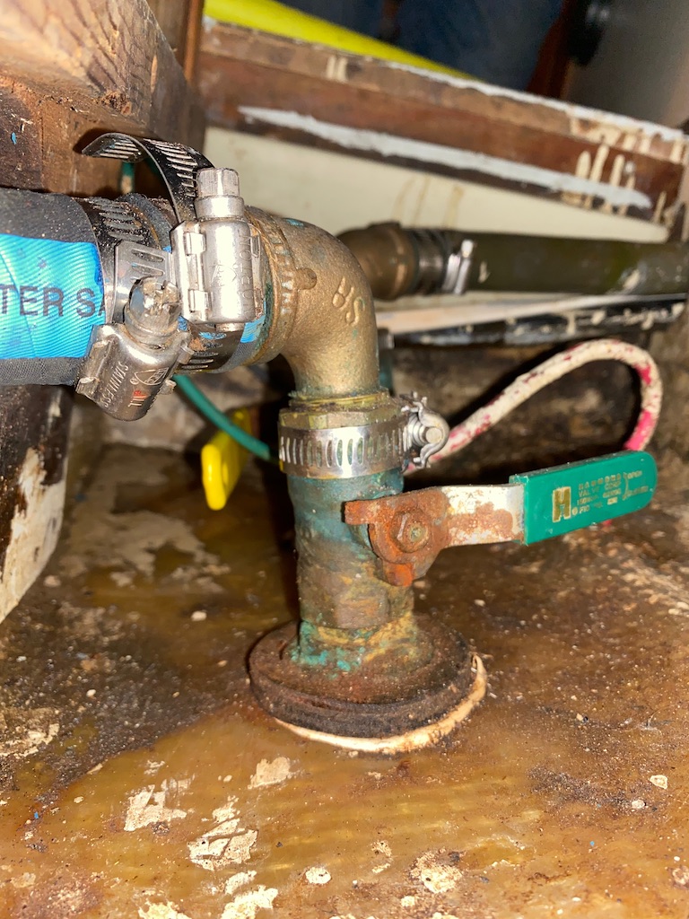

When I changed the sink drain hose this past February, I noticed a bit of stiffness in the valve. The 90-degree hose fitting appeared to be brass pipe nipple.
After changing the hose for the first time the area was dry. I decided time for a replacement was nearing. Right next to it is the Engine raw water supply valve.
Both are ¾ thru hulls. I decided I might as well consider both of them.

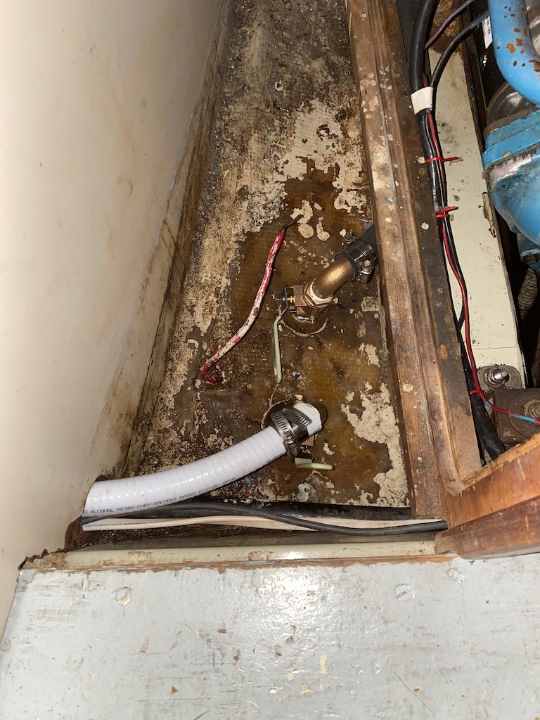

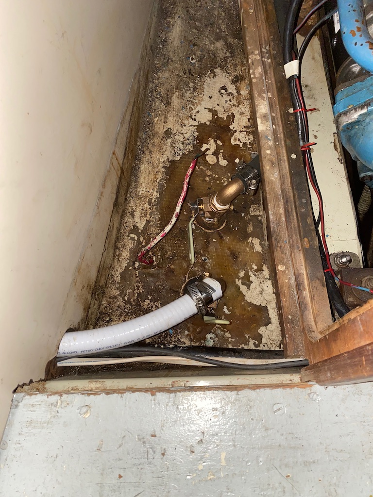

I started to make plans for a haul and then Corona Virus Lock downs hit. 2.5 months go by and I make my first run up to the boat. Surprise, “you got water” around the valves. It was only about a quart and a half, but where was it coming from? It did not appear to be salty on taste. It was a RED FLAG in my inspection protocol. I called the marina office. First haul date was a week from Thursday. I mopped up the water and there did not appear to be much in the way of leaking, so I headed home with fingers crossed.

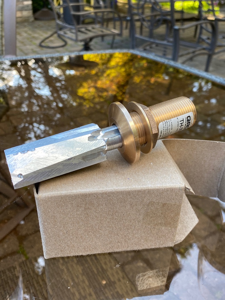

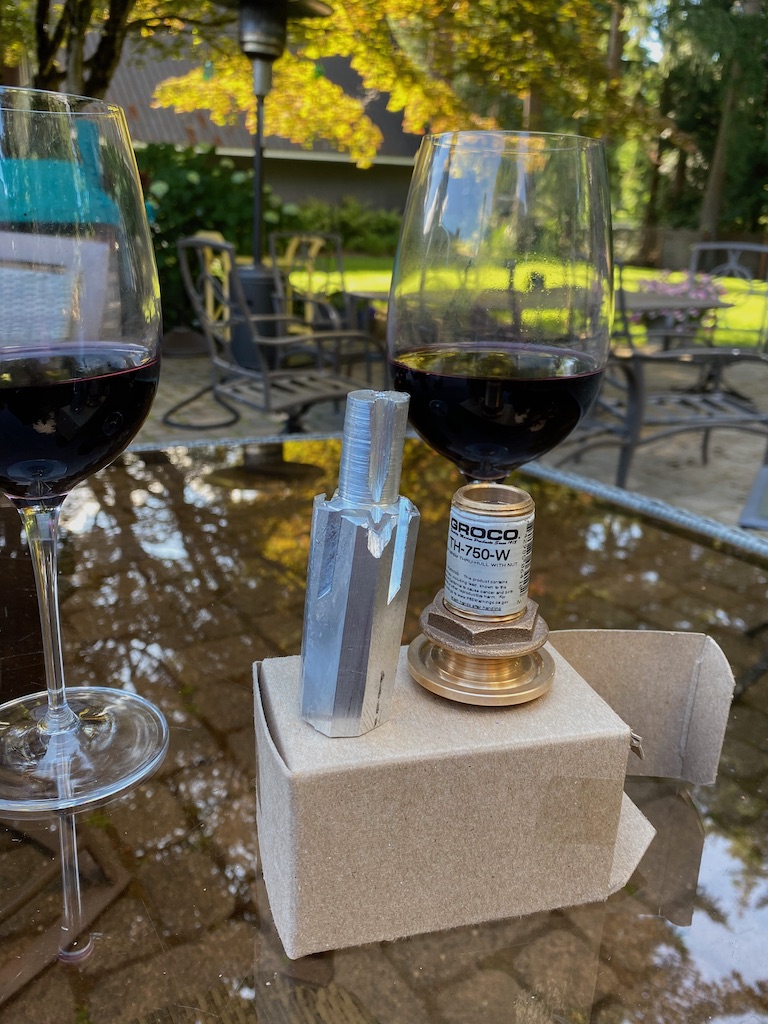

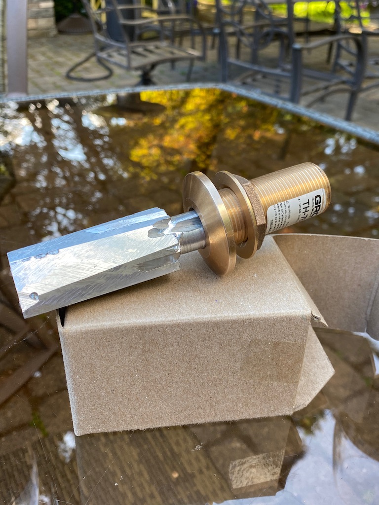

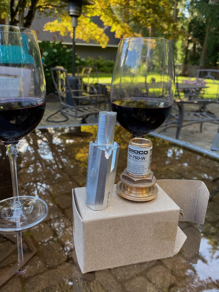

One week later, after a discussion session with @LeslieTroyer and some designing of a ThruHull Wrench tool, we were off to the boat.

Started up the engine and headed to the crane. Out of the water. Washed down by the yard, we had 12 hours to remove the valves, replace them before splash down the next morning. Piece of cake. Right.

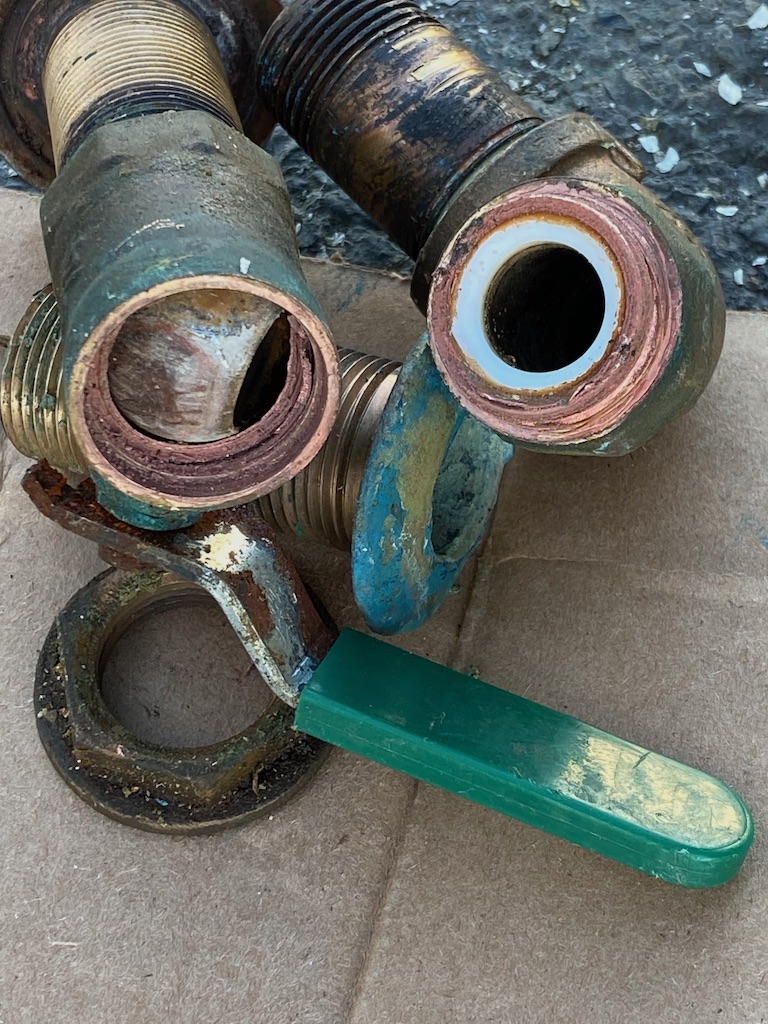

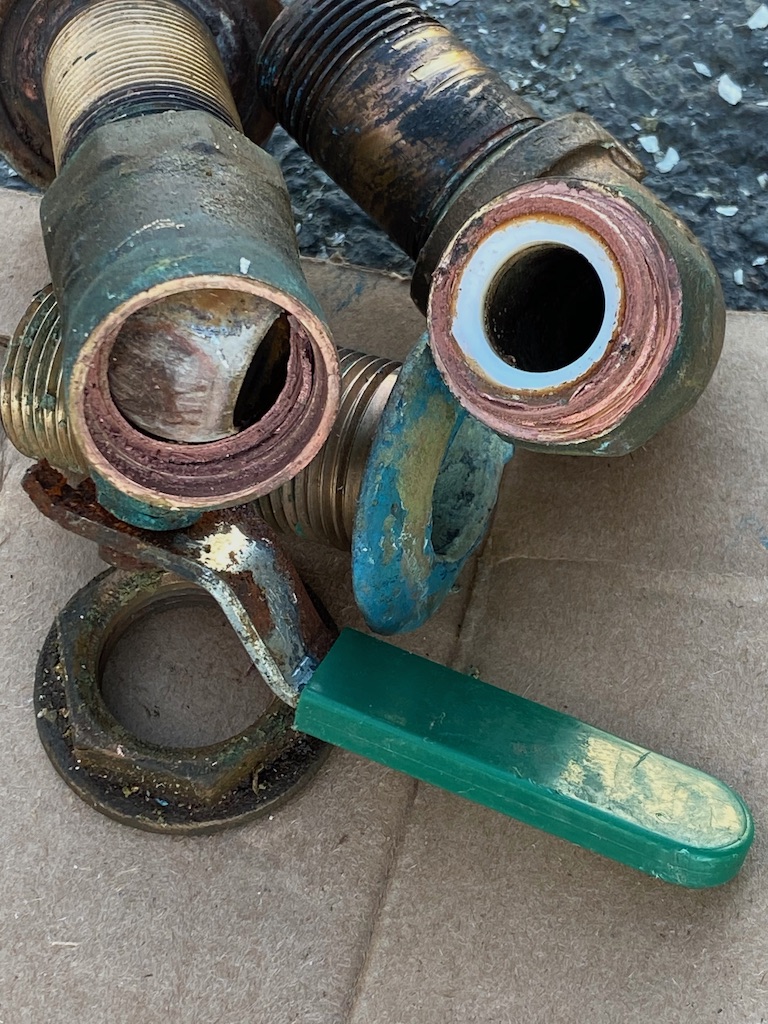

With help from SBO boating buddies @LeslieTroyer and @Ken Cross working under the boat, I started to remove the valves from the inside. The drain valve, the one that first started my concern, would rotate 180 degrees, but it was just spinning the thru hull. Darn. The thru hull seal is busted, it will need to be removed. Let’s try the better-looking valve (the engine raw water valve). I was thinking, I’ll just spin this one off and we’ll have lots of time to work on the bad boy. I put the wrench on the valve and started to twist. Pop the valve split in two and I was looking at the exposed ball in the valve.
What the… Looking at the valve the threads that were supposed to hold the valve together were nearly gone - corroded. It had been holding together on a prayer and good luck.
The rest of our efforts went smoothly. We splashed on time. The new valves look great.
