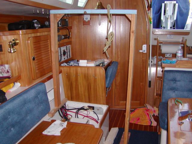

I understand your concern. I replace the 4D batteries. Here is what I made to remove and re-install the batteries. In this photo the batteries have already been removed. I did not injure may back. I had a back surgery done 6 months ago due to a crushed disk. Be safe.Each batery weighs 90 lb.
