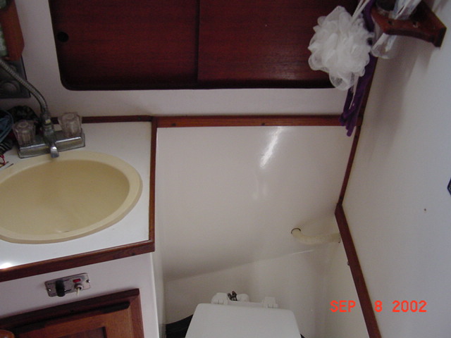

First************do not even think about a rebuild kit- not worth your money or your time
Second- is a pump-out station in your marina or near your marina.
If so- go with a Wilcox unit
If not- go with a small head that has a removeable tank- if you use the head lightly- this might be your best alternative.
I have a '79 Hunter 30 and the location gives you little space to work in
Good luck
