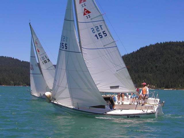

@JRacer is describing my old 155 for sure - it gets overpowered easily and performs poorly upwind. I purchased a new-ish 135 a couple of years ago and it is my go-to sail for cruising. My sails also hank on and I was too often having to swap between the 110 and 155 as the wind changed or to sail upwind to make it home.
Not sure if the headsail below is a 155/150 but it looks about right either way.

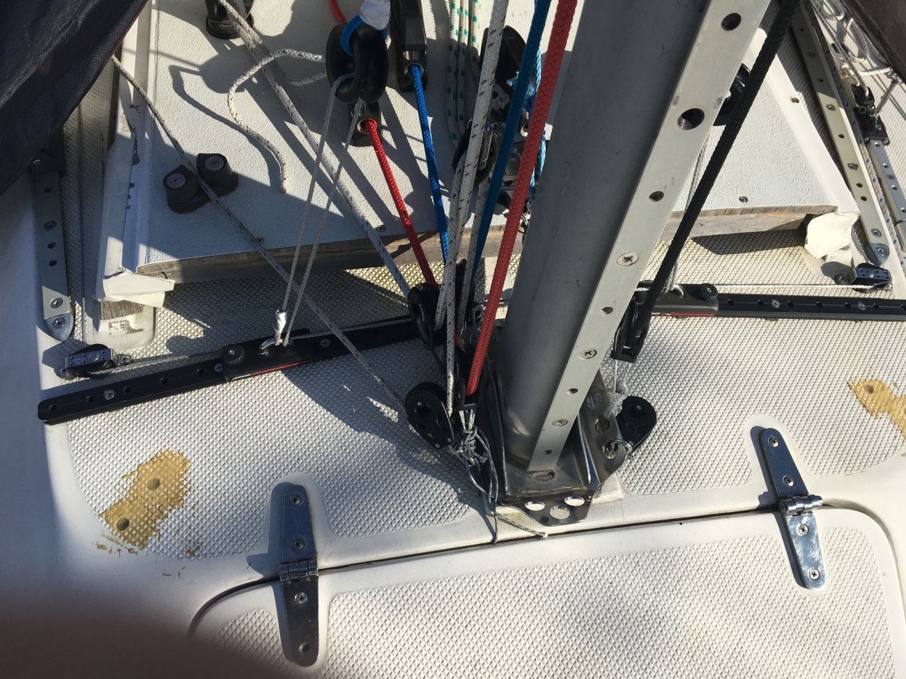

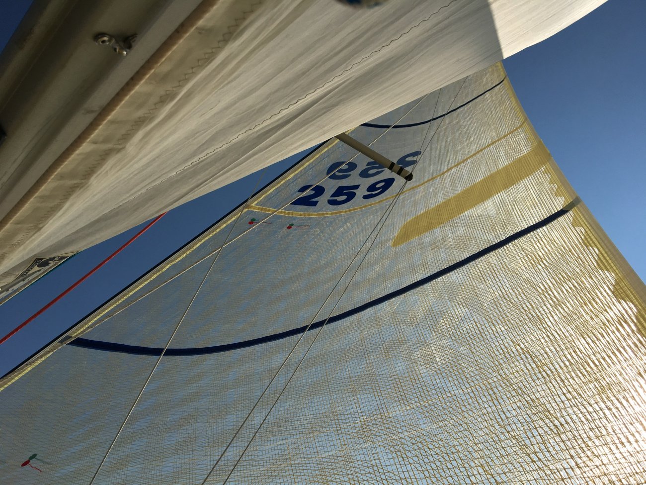

Yes, I have a 107% jib that I sheet inside of the cabin top tracks. See pic below. The posts above describe any old sail for any one. As sails get old the draft moves aft. It can move aft as much 15-20%. This can be seen best when you hoist a new and take a picture of sail when sailing to weather (close hauled). What to look for... the sail to be parallel to the shrouds at the deck to spreaders. When the sail gets older the middle of the sail at the spreaders will be further away from the spreader and tighter or straighter at the turnbuckles at the deck.
As the sail gets older we tend to make up for this by using more halyard tension. The problem is with more halyard tension this decreases headstay sag, and flattens out the sail. This reduces power to punch through chop, pointing, and increases leeway.
Regarding my jib, in short it's increadably FAST! The sail is sheeted from 4"-10" off centerline. See pictures below...Here is the trick to this the Main and Jib needs to be designed for this. Just because the clew is really far inboard does not mean the leach is also.
The boat will only sail so fast, my target speed on both tacks in 10 knots true wind speed is 5.9 knots of boat speed, at 12-15 degrees of heel, with 600 lbs of crew weight.
With my setup we sail slower than S2 7.9's and j 24s but we sail 1-2 degrees higher. My trick is not to sail faster because we can't, but to use the sail plan to and natural pointing abilities to sail a shorter course. With regards to reeling a Capri 22, use more twist in the main, adjust your shrouds, the boat will develop more lee helm with a reef and the bow will dive to leeward on waves and puffs. This is the wrong way!
This the best way I have found to win races against faster bigger boats, sail target speeds and sail a shorter course.
