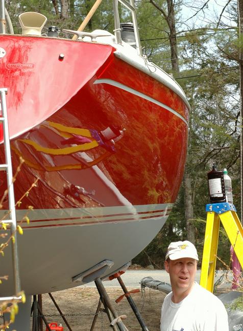

Hi All, Yep I'm at it again but this time with another forum members boat! I told Tim R. & his wife I'd help them buff, polish and wax their fire engine red, Imron painted, Ericson. Well, we spent most of today working on Cordelia and the results are amazing. I had never worked with Imron, so I was slightly skeptical, but I have to say this stuff is a dream to work with compared to Awlgrip! When I got there Tim was telling me how they planed on a new paint job withing the next year or two but I think after today they may be able to spend their boat dollars on other boat toys and postpone the paint for a few more years. We experimented for about a half an hour and settled on 3M Super Duty marine Rubbing Compound and a 3M foam polishing grade pad not a buffing grade pad. This combo worked very well with the hard Imron and left a fairly decent shine. The 3M Super Duty was followed with a polishing/glazing phase using Presta Chroma 1500 & Presta's blue wool pad. I'm always amazed at the magic of the Presta Chroma 1500 and it's diminishing grit! Chroma 1500 starts out about the same grit as Finesse It II but the grit diminishes to a true glaze saving an entire step! Tim's wife then came along behind us with a coat of Colinite #885 Fleet Paste carnuba wax. According to Tim his boat was painted with Imron in 1989 and after today it looks almost new! I have to thank Tim and his wife for allowing me to take part in the top sides transformation of Cordelia. Oh and thanks for the lunch and beer too!!!!

Looks great.
Almost inspires me to redo my 79 Catalina. Maybe next season since it would kill me to pull her now. It's good to know that it doesn't take a crazy amount of time to get it done. Well, we have a tendency to use the standard hours to beer ratio when working on the boats---1:2---so it may take a little bit longer!! ;D Love the red, too! You guys busy next April????? Jack Manning s/v Victim of Fate Atlantic City, NJ

Holy Cow
That looks incredible. I was unaware that Imron could be buffed. My boat yard tells me to just hand over 10k for a paint job! You mentioned a pad for the heavy duty compound do you know specifics? What did you use for a buffer etc. I need to do this to my boat. Awsome job and great color!

Tim you must be psyched
I have never seen a shine like that even when my boat was new! Maine Sail really does know what he's doing I'll have to read his posts more often & more closely. The real question is can you do it on your own now? Did he tell you his secrets?

Peter D.
The majority of the effect was accomplished using 3M marine rubbing compound, a Makita 9227 buffer set to low speed and a foam pad. Rod tried many different less agressive compounds before deciding that the rubbing compound was necessary to get through the hard Imron. Tim R.
