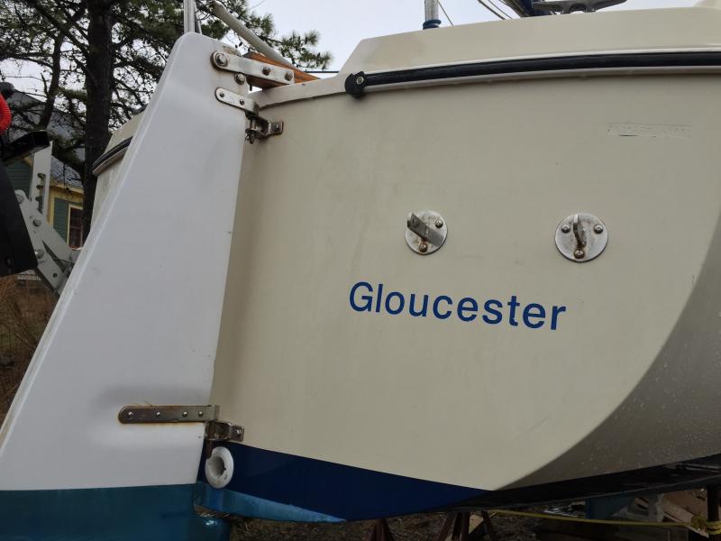

The bolt that connects the tiller to the rudder is really sloppy and has a lot of play. Is there a fix for this? I am new to the site and a sailing newbie. Thanks for any help.

It is in the hole that the bolt goes through. I have not taken it off yet. Someone on the site said to get a slightly larger bolt. Others say to fill in and re-drill for the current bolt. I think I will take it off and inspect it closer. I assume the tiller to rudder connection should be snug with no play.

Differences I noticed in your photo between your rudder/tiller and my 1980 25 rudder is the rudder appears to narrow where the pintles attach to the rudder. You also appear to have a bolt used as a tiller stop to keep the tiller from being too low. I may borrow that idea as my rudder has a step that the H of the tangs sits on. When I eliminate the H the tiller will not be supported except by the transom.
