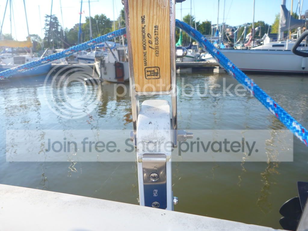

Indysailor, I did the same thing, I got a SS strap from WM and cut it shorter then bent the cut edge over in the vise to form about a 1/8-3/16 turn over. I drilled an extra hole in it and screwed it on the rudder. You can just see it in this pic.

Here's a pic of the SS strap I put on the front edge of the rudder, it makes a solid surface for the tiller to come down on.

Thanks for posting that photo. I don't see where you bent the strap, though. I was thinking of a strap running horizontally, turning 90 degrees around each side, but if that has worked for you I think it looks like an easier way to go.

The top edge of the strap is turned over 90 degrees about 3/16" on the top.
You can see the chipped away FG under it.

Got it- thanks again.
