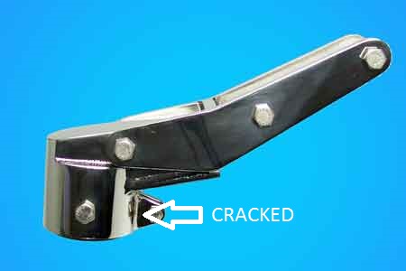

The tiller head flange cracked on the C27. I noticed that the tiller seemed sloppy a long time ago but assumed it was the characteristic of the boat. While replacing the sheaves on the traveler I noticed it was cracked. Should have taken a picture of it but the phone was 10ft down in the truck.
Seems like a lousy design for cast bronze. I am afraid of cracking the replacement one. Any suggestions or recommended torque?
Will the rudder fall out when old cap removed?

Haven't had that coupler of yet but I have a feeling that Catalina was relying on friction of the coupler clamping down to hold the shaft from rotating. The through bolt right now is the only thing keeping it from rotating. The crack 1/16" gap is right at the tip of the arrow but on the other side.

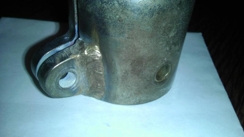

Had cap welded yesterday and he did a great job. That shouldn't break again. Notice the small dimes he laid down. Worth every bit of $20 and then some.
