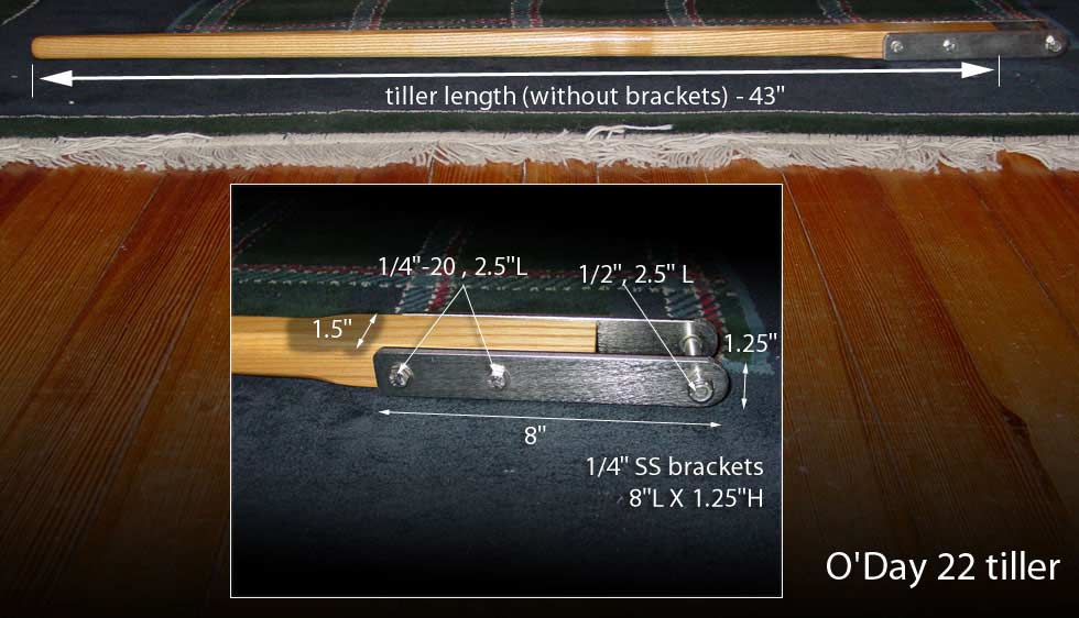

I can tell that the tiller on my new (to me) 22 is a replacement and in addition, has been repaired. Could anyone provide a digital picture of what the original tiller should look like? I want to make a new one, but I want it to be as close to original as possible.

A few days ago I ordered a replacement tiller (ash?) from Rudy at D&R marine (I also have that aluminum tube tiller, and want something a little cooler looking). It should be on its way. When it arrives, I'll measure it up, take a picture, and upload you the dimensions and photo.

Thanks Ed! I've been weighing the build your own versus buy one and I'm leaning toward buying one as I have a plethora of projects already. Looking forward to the picture

Jinks- Sorry for the delay in uploading this photo. Parts of my order were backordered, so I just received the tiller earlier this week. Hopt this photo helps. Ed
