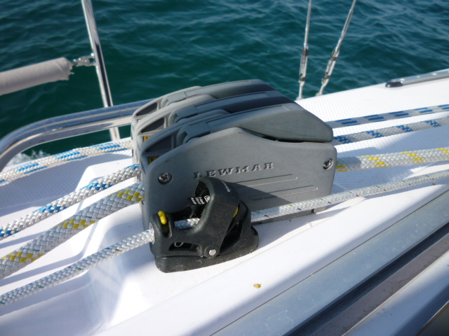

On windy days, a second reef would be nice. That would certainly help balance the boat out. Your idea of prerigging to a second reef before heading out seems like a reasonable solution to running a second line, except it may feel like going out windsurfing and guessing the wrong sized rig. It would be nice to have the option to be able to change reefs on the fly. I wonder if there is enough room to squeeze a fourth clutch on the port side?:
From this prospective, it may overhang the front:
I really would hate to have to drill and tap all new holes to rearrange the clutches to make it look nice. I remember someone mentioning adding a second reef, but I don't know if it was done. Definitely did not make it into the "Pimp" thread.
