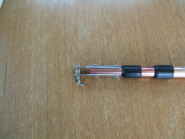

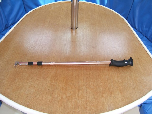

Why not adjustable?
Here's my $12 Walmart hiking stick. I used the connection from an old non-adjustable extension I had. I did have to add a screw to hold the handle on because it is made for downward pressure only and pulled off.
