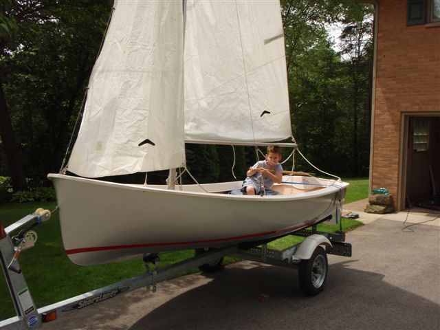

I have restored a 1969 O'Day Widgeon, made some nice upgrades, but have not sailed her alone yet as it seems to be a "reach" to control the jib sheets and the tiller together.
Does anyone have any experience or recommendations regarding adding a TILLER EXTENSION?
