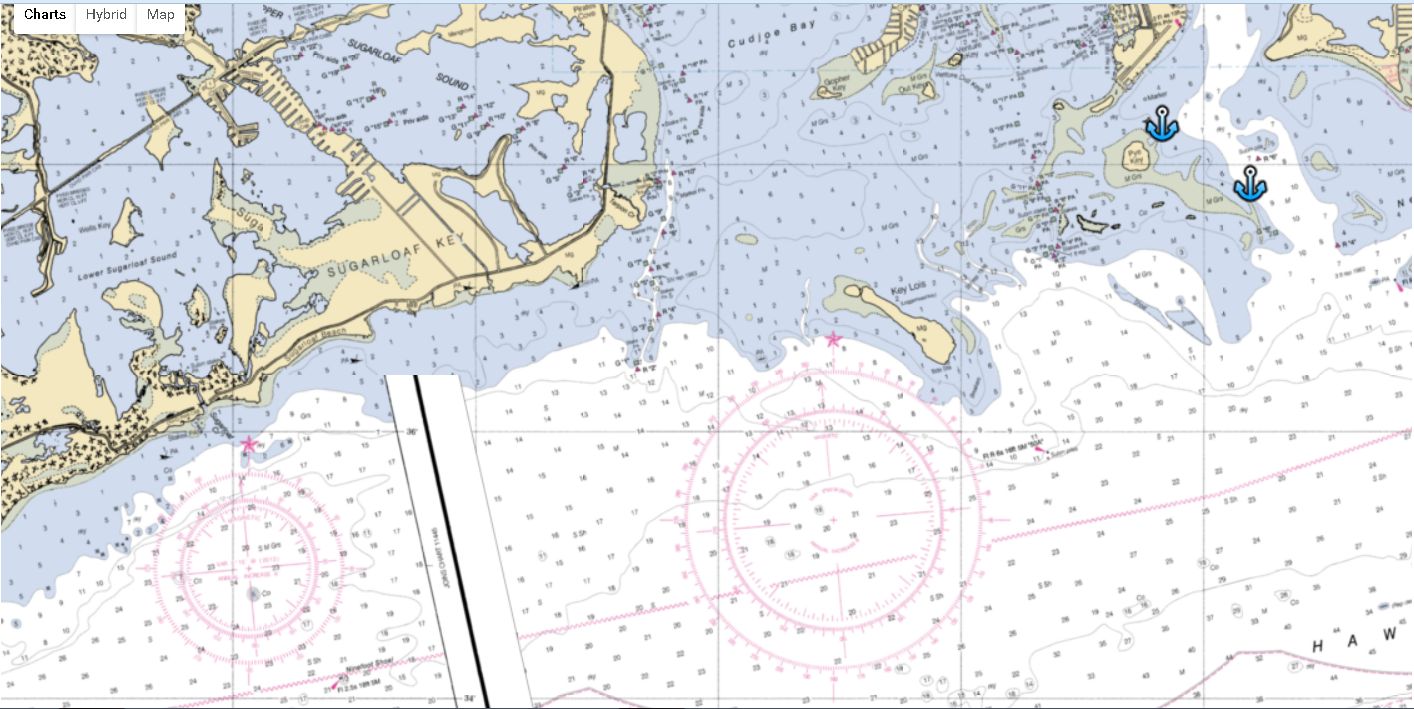

Below is a chart where I was sailing, East and West about a mile South of the last channel markers.

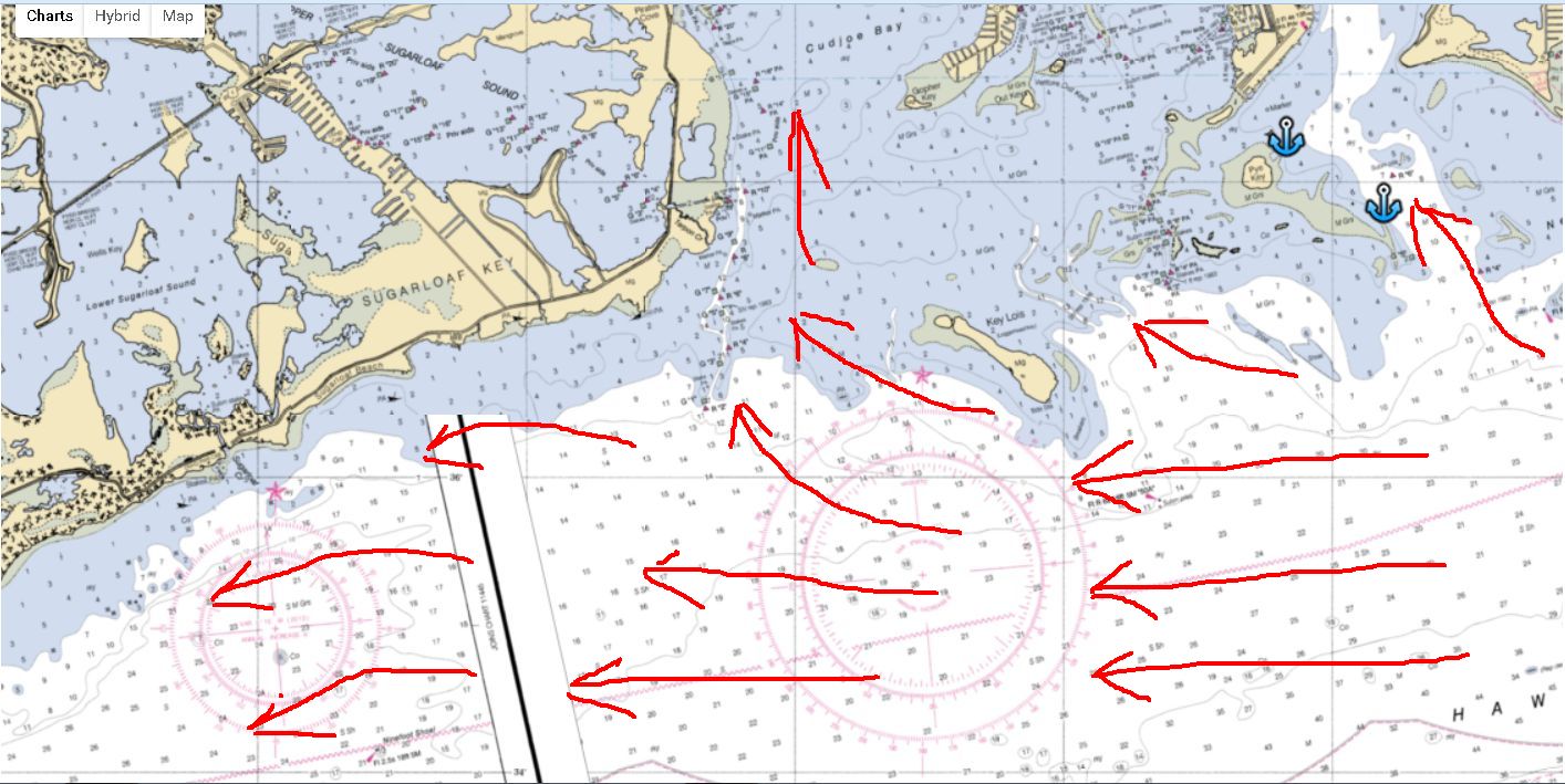

Jan 10, 2016
127
Islander Wayfarer 37 Sloop Key West
Would this be approximate of what a rising tide current would look like? (up is North)

Jan 6, 2010
1,519
Jim,
In my area, we have a North/South current along the coast. However, the direction can & does reverse itself.
Also, current direction can be influenced by the shape of land mass. Think of water & air, if there is a deciding factor in angle of current, yes it can be mostly directional. You have a large Atlantic ocean interacting with a much smaller bay & also, the spinoffs from the Gulf Current. There are numerous factors that come into play. Planet rotation, prevailing weather, large vs. small bodies of water, landmass etc.
I've sailed the keys several times & there is I believe a unique set of current factors in your area especially passing East & West with tidal movement.
I am sure there are those in your area or online that can give you greater insight to you questions.
You only need seek them out. I am very interested in what you discover, as are the members in your thread.
We await your findings sir,
CR
