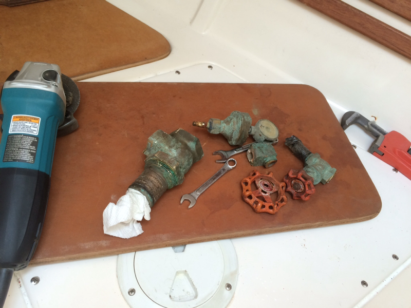

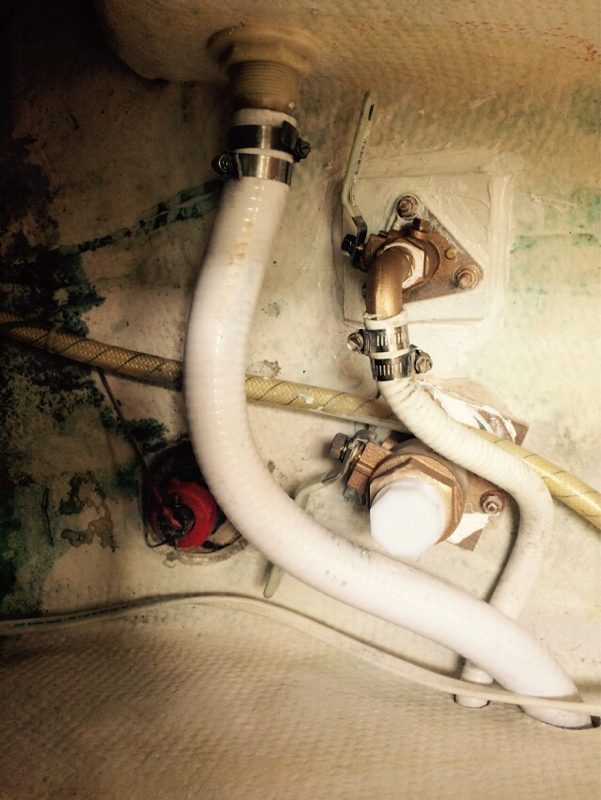

Just finished doing the job on my H27. Not the worse job i ever tackled, but right up there! I agree about the tight space for pipe wrenches. Ended up cutting the old gate valves apart with an angle grinder. Make sure you dry-fit everything first before you drill holes to hold the flange. Btw, if you've got a set of tap & dyes, you can use a large one for the thruhull tool. Saves a few $$. If ya end up cutting them out, you'll probably have to remove the thruhulls and repair the threads.

An oscillating saw is great for tight spaces. All my gate valves on my H30 were frozen. I cut them all off, bought all new bronze thru hulls and flanged seacocks. Instead of plywood backing plates I used g10 fiberglass sheets bedded in glass reinforced resin.

The seacock in place is probably original to the boat. So it's been wanting to come out anyway. Check out Defender and others for the Marelon replacement. You can choose the head (hose end) angle from the Forespar website and then shop for that model number online. It goes in with just a little elbow grease and 5200 (use nothing else for it). You'll need to make/adapt a tool for a second person to hold the through-hull on the outside (I have one I made-- should get patented!).
If the inside of the hull is too concave at this location, make a backing plate out of fiberglass board, G-10 or even plywood (saturated in epoxy), and don't be afraid to make the backing plate much bigger in area than the base of the seacock or anything you may have removed from it. (My bet is that the old plywood backing plate will come off with a few light taps with the chisel. If so, it wasn't on with 5200.) You can get smallish blocks of fiberglass board from McMaster-Carr and others. The thickness isn't important-- only for the ability to shape it to contour to the hull. What's more important is the area, especially when using consumer-spec Marelon seacocks (I got OEM spec ones, which install differently).
When installing, DO NOT SPARE THE 5200. Usually I trowel up the excess and make a nice fairing about both the through-hull's mushroom head outside and the backing block inside. This is good for streamlining and for not providing places, inside or out, for gunk to find a home. Do not tighten till there's nothing left, but stop at about the first grunt. Make sure the lever on the inside is aligned how you want it and have the outside person turn the through-hull the last measure.
