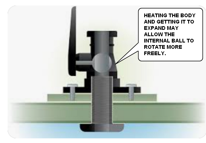

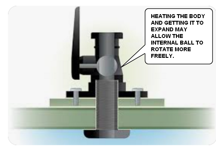

Can you provide a picture of the thru hull for the engine ? Given my druthers, I'd rather not leave the engine thru hull open as there is where the most shake, rattle and roll occurs.
Given a picture of the thru-hull, you "may" be able to heat the outside of the valve body in order to free the interior ball of the valve.
24,938
He talks about the valve, identified as "MARELON" that is "stuck". If that is the case, I would think heating the plastic/nylon valve would be quite dangerous.
I would be inclined not to do anything till I could get the boat out of the water and safely work on the valve. But that is just the cautious me.
I’ll try and share a photo. It is in a very tight spot. Guess you are think a heat gun to warm it up? this might damage the hoses. I have 3 thru hulls. One is stuck, one opens/closes and the other I need to test
Mar 1, 2016
279
Oday 28 Tracy's Landing
I agree.
