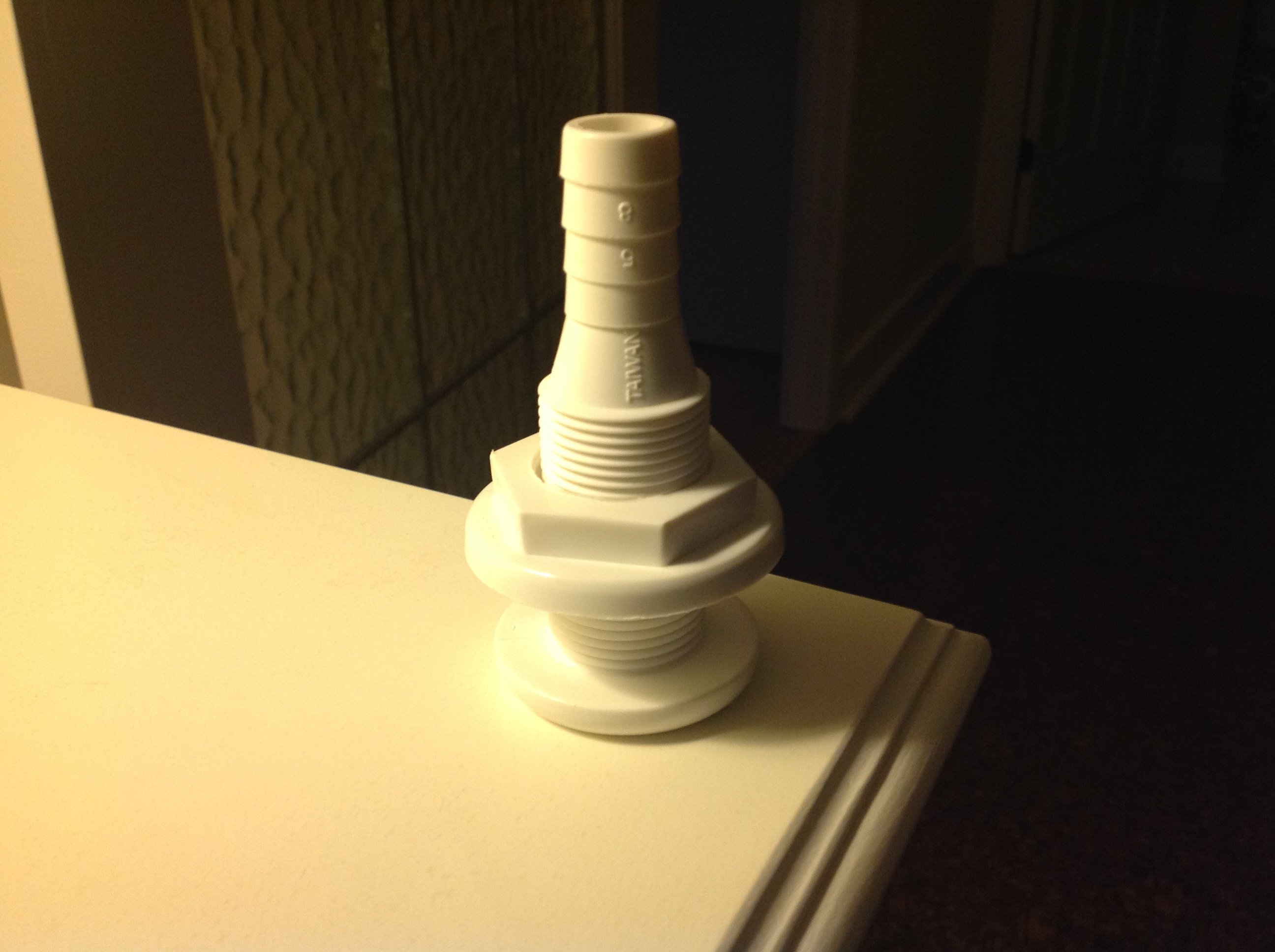

My 343 came with a heat pump HVAC unit. The supply line with pump valve strainer and thru hull are all installed. All else needs installing. It came with all the bits and pieces, so the first item on the list is to locate the discharge thru hull fitting. My question is how high above the waterline should the discharge be located?

4 inches or so. There is no up-side to it being higher, and it only makes more of a splashing noise in your slip when running.
10,195
I agree.. just high enough that you can see the stream and hear it.. Since it is a closed system back to the inlet thru-hull, no loops or stuff like that is necessary.. I installed mine with the boat in the water and did my measurements carefully so that when I drilled the hole, no water came in.! Still it puckered me up a bit to do that!

So I searched for old threads regarding the proper sealant to use for a thru hull above the waterline, but could not find it again. So, I'll ask. What sealant is recommended for this thru hull fitting above the waterline?

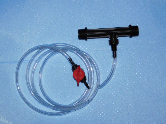

While your at it you might want to add a venturi injector and suck the condensate. Beneteau's because of there design ( closed matrix)it's not good to dump in the bilge.
I'm just installing one.
Thinking of doing the same on my IP's Mermaid condensate pan. What kind of $ does Bene get for their venturi unit?

I think the Bene one Mermaid condensate is 200.00 us .The one above is 20 bucks or less on ebay or amazon. This a copy of a Mezzei injector which a lot of people have installed on boat A/C. There is a built in check valve that won't allow water back into condensate pan
