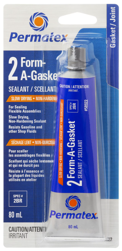

Do NOT use only teflon tape. Teflon has earned its popularity because it's nice and tidy. It often times leaks under cooler temperatures because it does not "flow" into micro leaks in the threads whereas when hot, it does.
The ultimate thread sealant at all temps is a mix of teflon tape first followed by a light smear of Permatex #2. 100% success every time.

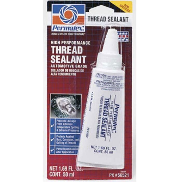

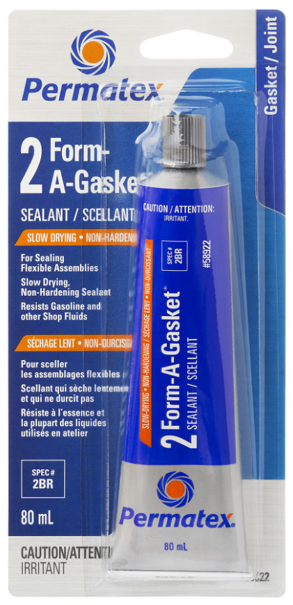

Thanks!
I postponed installation today to get this…… I like the idea of this much more than regular pipe dope. even though I have never had an issue….. but especially because I have to position the valves and fittings in a specific way and most likely won’t be aligned as I need if I fully tighten them in. I need about a 1/4 turn of forgiveness on each (other than the skin fitting).
thanks!

I swear by this:
Used something similar when I worked at the power plant except that brand name would offer certification for nuclear piping. No need for tape. Just coat the threads lightly and leave the bead that forms from the squeeze out around the threads.
