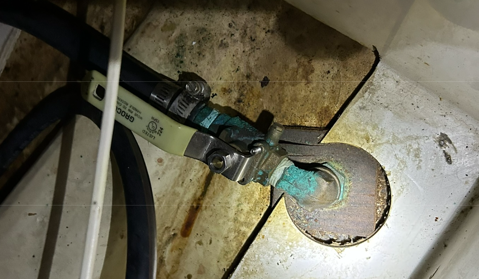

I am looking at my through - hull penetrations on my 1983 Hunter 34. This is a picture of the cooling water penetration. It appears like wood is sandwiched between the 'nut' on the inside of the boat and the 'flange' on the outside of the boat. Is this common? Thoughts?
