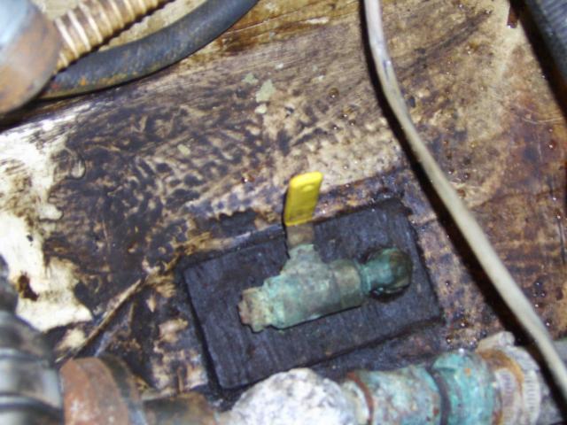

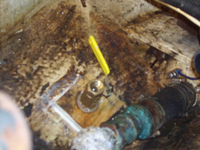

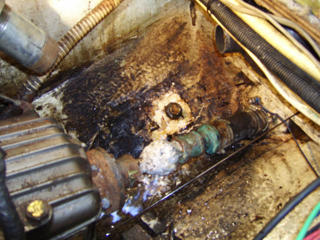

We removed the old broken raw water intake thru hull this afternoon and replaced it with a new one. The diver did use 5200 to attach and seal the job. He says he has installed in the water thru hulls as large as 4". The photos show: (1) the old thru hull; (2) ready to take the old one off - you may be able to see water coming in around the thru hull, and; (3) the new one installed and ready to go.

Did he just put 5200 on a through hull and then jump in the water with it, pull the old one out and stick the new one in?
Is that a zinc on your prop shaft inside the boat?
By the way thank you for documenting that and sharing it. Now I can say I have seen that done.

In water change out prep
This diver has done a lot of work like this and has a system down. One of the first things he did was put a very thick bead of 5200 around the thru hull. He said to leave it in the sun so that the 5200 forms a "skin". He then went about preparing to take the old thru hull out. Likely took about a half hour to an hour before we were ready to install the new one. I imagine the set up 5200 better fills the hole around the thru hull and seals better when it is cured a little. The whole process went smoothly.
