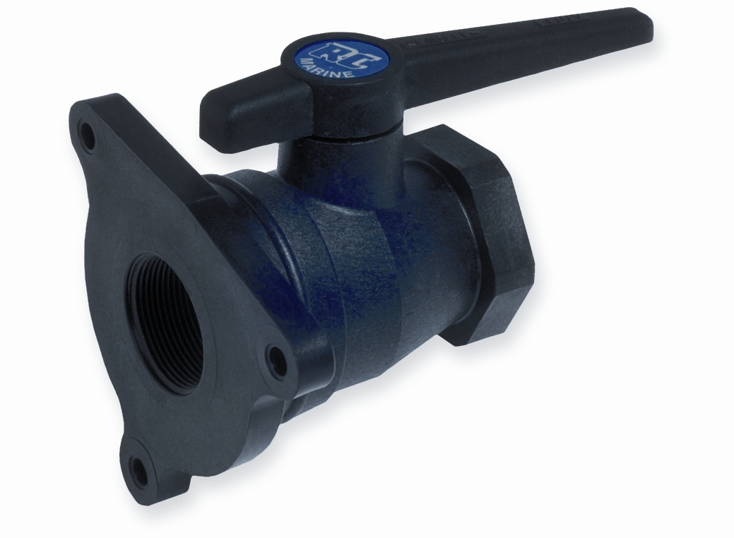

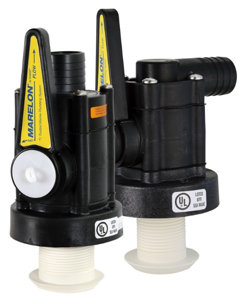

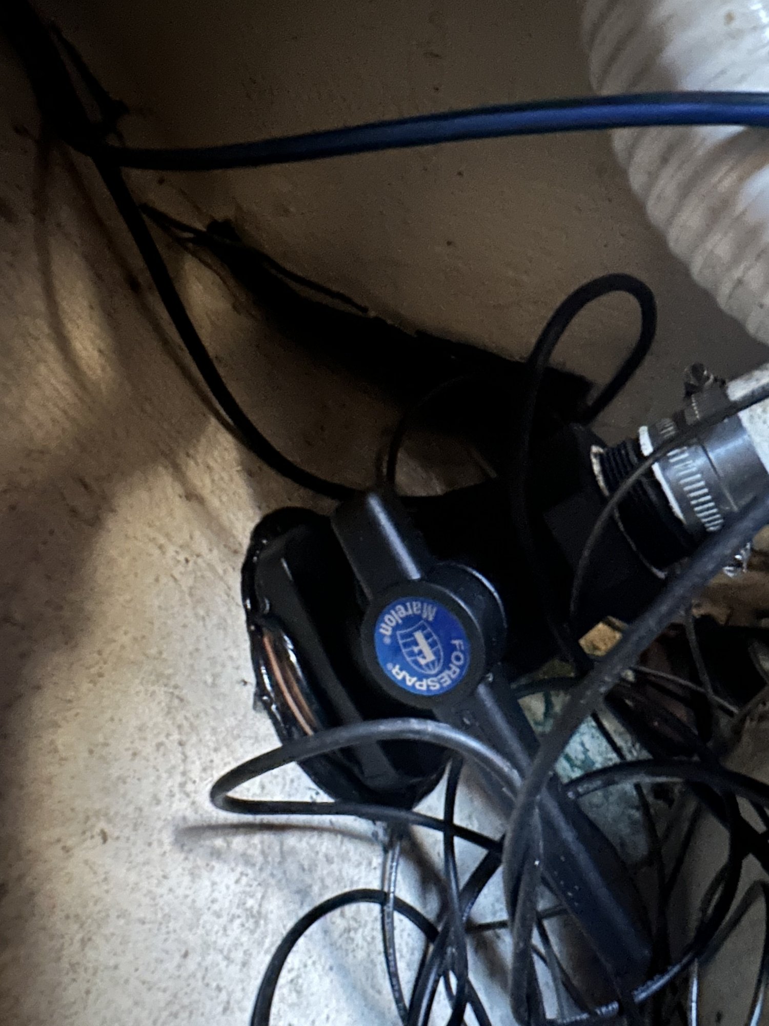

Which Marelon valves do you have? If Forespar brand, then only the 93-series are good. Their other less-expensive ones are notorious for seizing up and handles breaking. Those should not even be sold, and I don't know why they still do. The two look different. The 93-series looks like the first picture, while the regular ones look like the second picture.
If you replace, Trudesign makes better reinforced nylon valves with teflon ball and housing, and I've never had one stick.
Personally, I only use reinforced composite valves/thruhulls (Marelon is a trade name for it). But it is important to use only specific ones. Brass is a no-go, and bronze is more expensive than necessary and a potential galvanic issue.

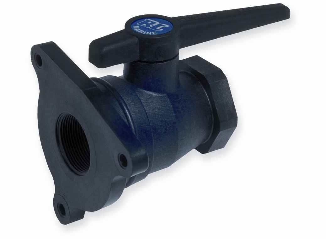

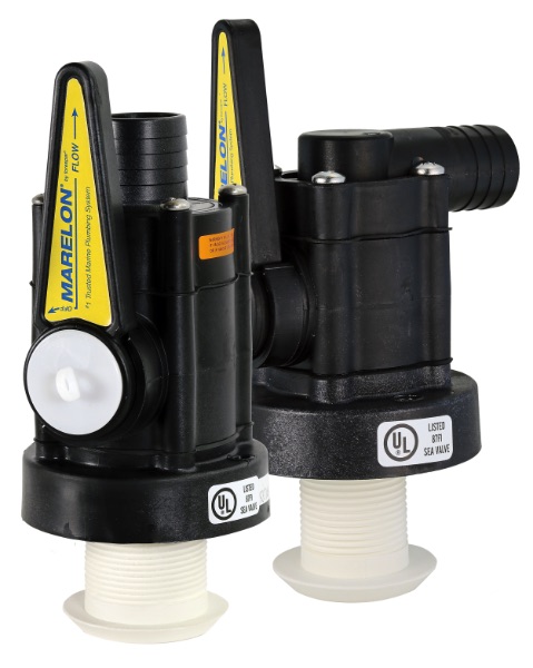

No marelon hits on a search at discount marine!? this is what I see on West Marine. Nothing indicated series 93. Flush Thru-Hull Valves | West Marine. I found it on WM: Mushroom Thru-Hull Valve 1 1/2. Based on the price I must not have the 93 series. You recommend not trying to fix the exisiting fittings and move forward with replacements to the 93 level?
Here's one:
24,873
A good idea if you would like to reduce the worry about your thru-hulls. If you are not concerned about the possibility of them leaking/breaking off in your hand, then fixing them is a solution.
If you have the one you linked to at West Marine, then that is a 93-series and should be OK. Just find out what is causing it to stick. They are generally easy to operate, but if you have something caught in it, that could prevent it from turning.
If you have one that looks like the second picture above, I'd get rid of it. Either for a 93-series, or even better a TruDesign brand one with collar.
We have both 93-series and TruDesign thruhulls. The TruDesign are better, but the 93-series offers more configurations for special purposes like 3-way valves (which is why we have two of them).
Mark

May 5, 2008
53
Oday 25 Washington DC

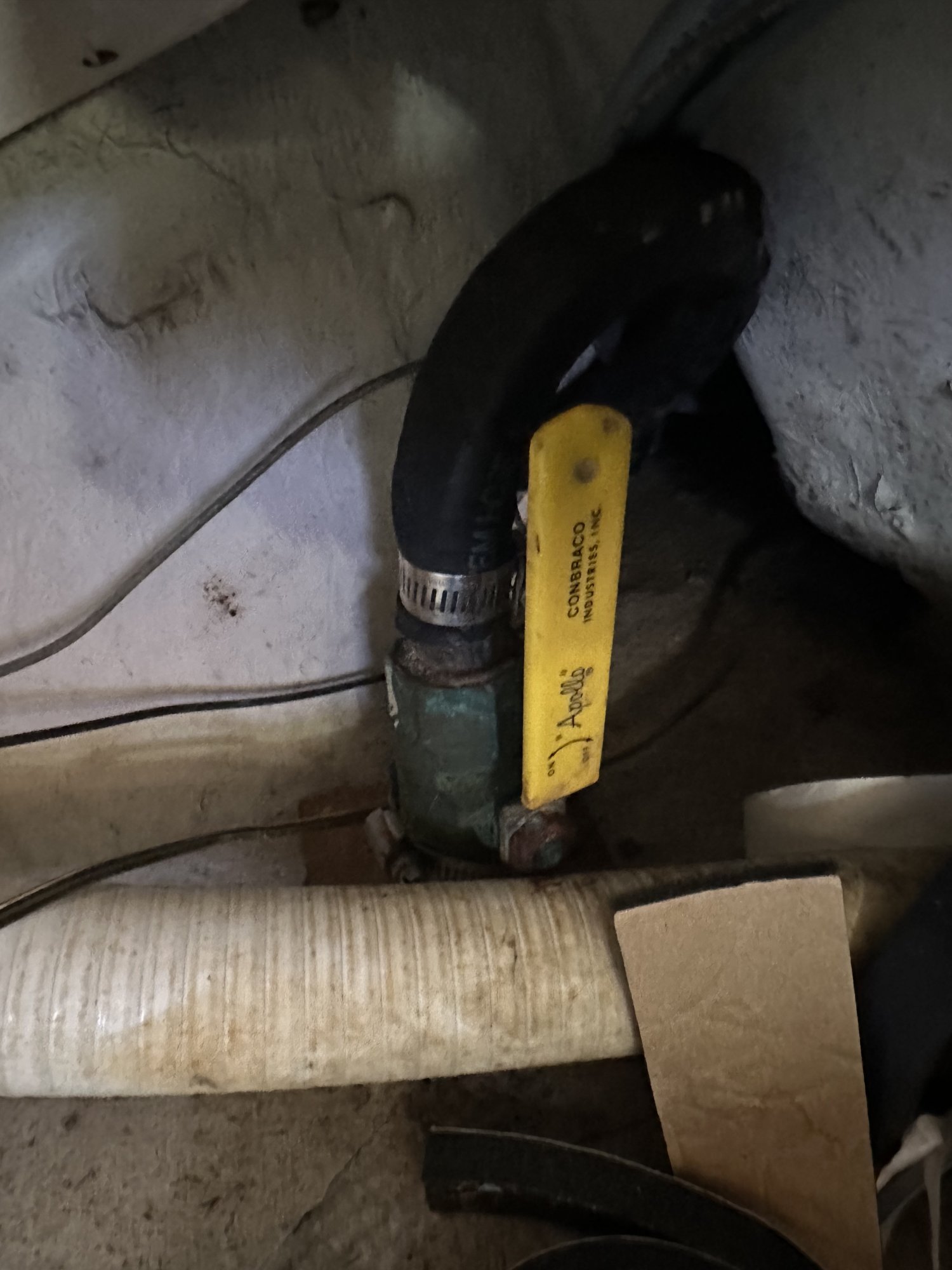

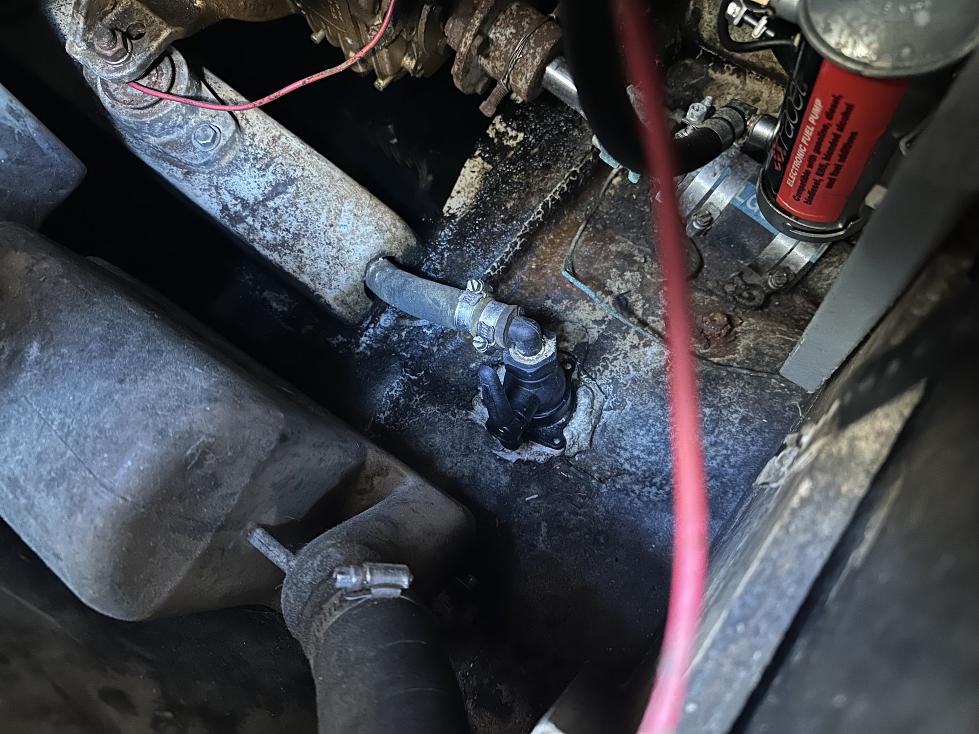

My head discharge valve opens and closes fine. My sea water intake for the head works as well. Here are their photos for what it is worth. They seem to be good quality and are the same age as the water intake for the motor cooling.
