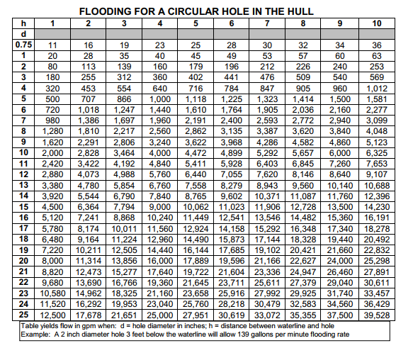

This might help, though backwards. Interesting, at any rate.
But don't forget the water pressure if the thruhullis below the waterline.
