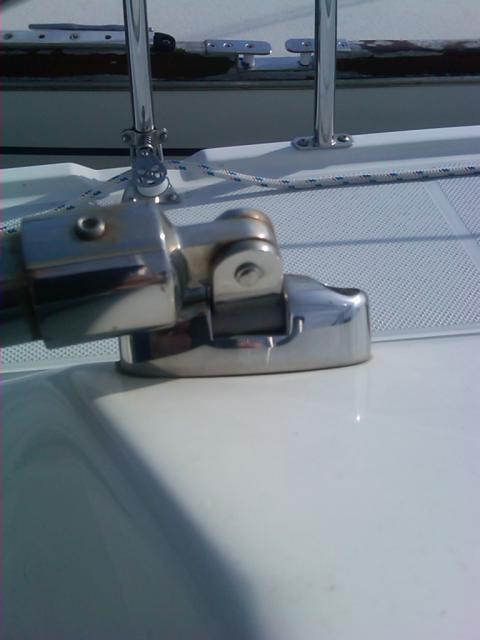

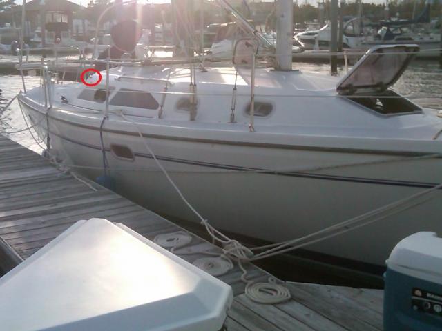

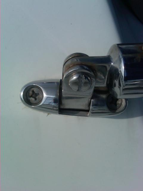

So I had planned on rebedding my dodger frame as instructed by several helpful people on the site. Today, i took advantage of the nice weather and went to the boat to scope out what I thought was going to be a simple project. When I arrived, I was surveying where the bolts would come through and noticed that:
#1. The iterior cabin to is not shaped like the exterior, and
#2. When I tried to use the winch location as a reference I noticed that there are no bolts coming through and that goes for pretty much all of my hardware on top of the cabin.
Figuring that Catalina didn't jsut screw the winches and rigging hardware to the cabintop, I assume that there is a headliner inside and i can't get to the bolts...but then again, how would they expect me to replace/repair things if I can't get to them?? Please tell me my hardware isn't just screwed into the fiberglass.
Has anyone through-bolted anything to their 310 (or other similar style or sized boats) cabintops? Is there a secret way of doing this or am I overlooking the obvious? Any suggestions?
I attached some pics to give you an idea where the frame is mounted.

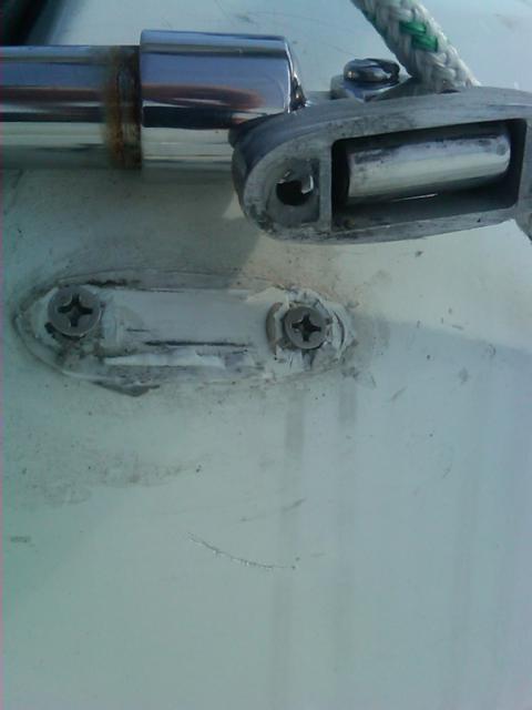

The frame was screwed in with woods screws and one ripped out because people were using the frame as a handrail. It has been suggested, since there is a decent amounf of force on the frame while underway, that it be throughbolted. I felt that it was the safest and most logical thing to do. Of course, it seems like it is going to be a lot more difficult than I anticipated.

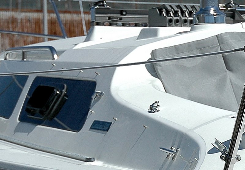

Steve,
Many dodgers attach to a flat surface and the force is down. The C-310 dodger attaches to the cabin sides and screws are NOT enough. This was a very, very poor installation choice by JSI. Our failed too potted with epoxy and sold the boat...! Screws are simply not enough in this particular installation. One green water event and that frame is a goner..:doh: Ideally it needs to be through bolted through the cabin sides and into the liner.
The dodger attachment point is right behind the aft port:

It may depend on how strong your liner is, and there may be a big dollup of epoxy between the liner and deck. I added a number of sheet stoppers and a dodger frame to my B323 cabin top. My dodger mounts are like yours(and about at a 45-degree angle) and they are thru-bolted into the cabins. I took a fender washer and bent it curved to the liner shape and used a locknut, but turned the bolt from outside. It's only tightened down a bit. I see that when people grab the dodger frame, it gives, and the load on the deck fitting does not seem all that much. Most bolts in the cabin have acorn nuts added, but on some I put eye nuts to use for clothes hangers or some dual purpose.
