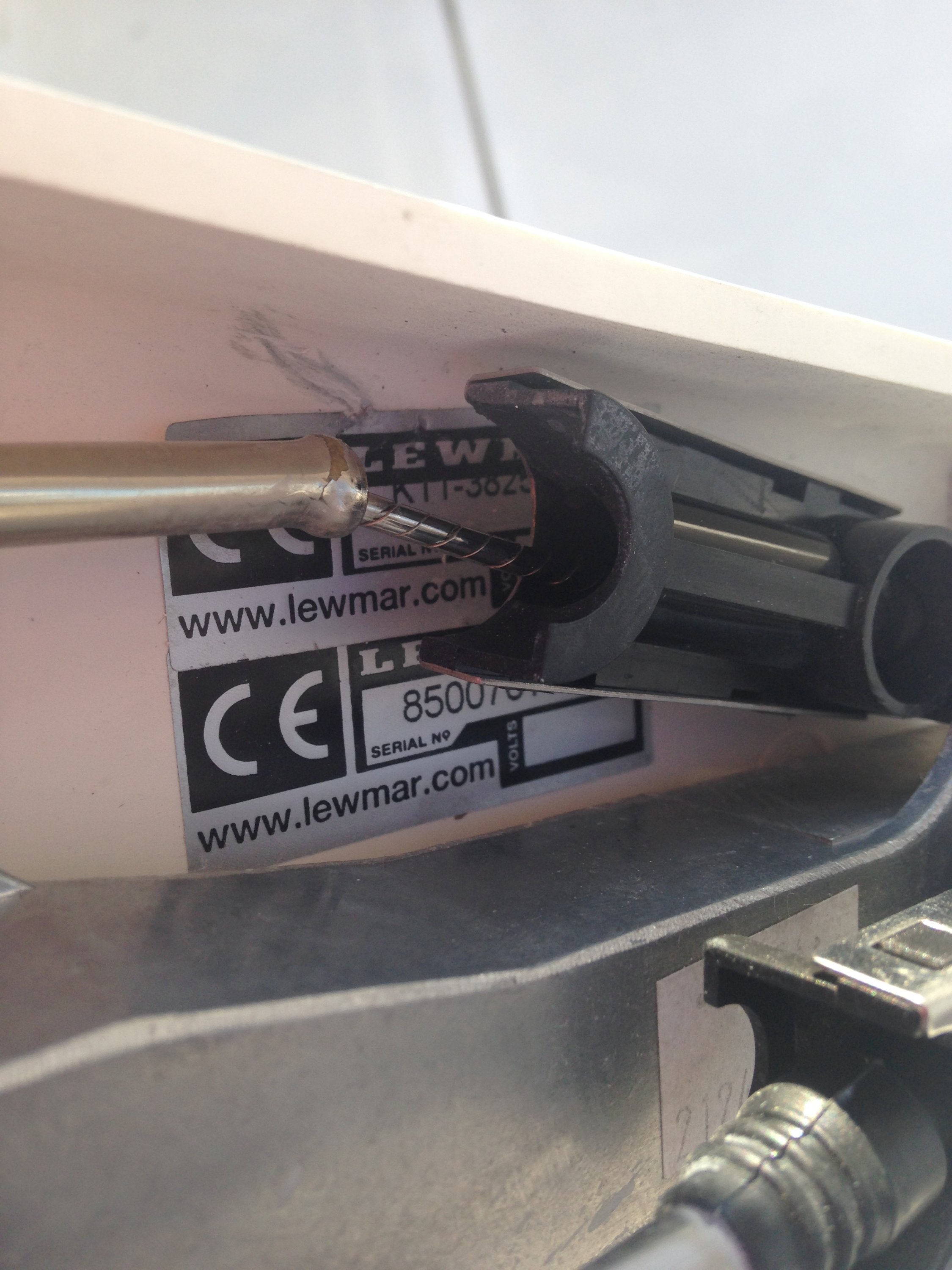

Throttle / shift cable broke inside shift pedestal where it enters shift housing. This plastic piece holds metal cable housing in place, they pulled apart ending their marriage. This is a Lewmar shifter. Two stickers with serial numbers are inside. I'm guessing one is for the forward throttle cable and other is for reverse. Lewmar website doesn't list the part. Any thoughts on finding the cable and parts I need?

One cable is push/pull for transmission forward/reverse, other cable is throttle.
Cables themselves are "normal" "Morse" cables or "Teleflex Morse" but they come in different lengths.. It looks like you may have a cable holder ("snap on cover to retain cables" in attachment, page 3) broken (that would be a Lewmar part) and a cable end that has been kinked/bent..
This shows how it goes together:
http://www.marlow-hunter.com/wp-content/themes/marlowhunter/export/Miscellaneous/Lewmar shifter manual.pdf
Looks like a "service kit" is available in the UK and they should be available here in the USA too:
http://www.winchservicing.com/_Whitlock_Lewmar_Engine_Control_Fitting_Kit-47-3.html
I think the "Fitting Kit" part number is 89400146 You'll probably have to call them to get one.

Found the kit for 37.00 but company is looking for the cable. I'll pass on the 3300 series to them it should help.
