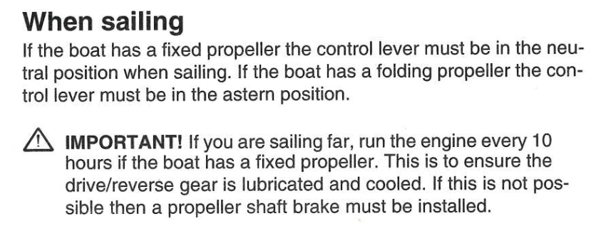

The answer to your question depends on the drivetrain being used, who manufactured it and what type of prop you are using. A Volvo Penta (MD series 2020, 2030, 2040) setup with a sail drive recommends the following. Note that there are different recommendation for a fixed or folding prop.
To add to this a ZF Marine (Hurth) SD-10 gives the following caution:
"CAUTION. When the boat sails with engine switched off the shift position of the gearbox can be:
1) in neutral position and in this case the propeller is free to rotate.
2) in the opposite position of the travel direction to lock the propeller.
Note: do not put the shifting lever of the gearbox in forward position, otherwise the transmission could be damaged!"
