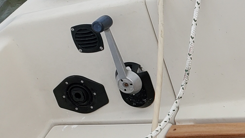

The throttle doesn't have a visible brand label. I'm sure it's original to the boat. The mechanism to disengage shifter is broken but functional (barely). It is a piece that slides on the pivot shaft at the base of the lever. Engine is a Yanmar 2GM. I'll get pictures next time at the boat.

Found a picture. You can see a piece of white plastic behind the lever that slides towards the boat to disengage. Was able to move it with a screwdriver.

Update: Joe, you were spot on. The unit in your picture is a seastar, and reviews are great, saying it works with Yanmar. Responses like these are why I joined the forum. Thanks guys!
