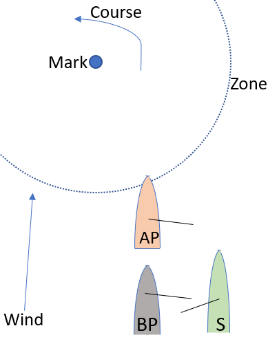

Coming into a leeward mark this evening I think I unnecessarily gave up a big chunk of time. Looking for advice on how to handle it better next time.
Three of us were going downwind to a port rounding, with the next leg a port tack close reach. Wind was just slightly from port of DDW. The leading boat and I were on port gybe, and outside us was a boat on starboard gybe -
I was BP, clear astern of AP when he reached the zone. Based on coming into the zone that way, as far as I know, AP gets mark room from both S and myself. I was fine settling for that, figuring I'd follow AP and get mark room from S once we got into the zone. Before being in the zone I didn't want to go too far right for fear of fouling S. Unfortunately that fear led to this -

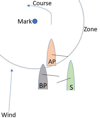

AP lost speed coming into the mark, likely because of all the bad air from S and myself. As he lost speed, and I didn't want to foul S, I ended up inside of AP, knowing I had no rights to room there. I tried turning the rudder furiously to scrub speed and get back behind AP, but by the time I realized my predicament I had too much momentum. I ended up bailing out and doing a 360 to follow them all, but it was about a 2 minute loop in dying wind. We ended up losing to S by 14 seconds, and AP by 90.
Did I have any alternatives to avoid fouling the other two and not need to bail out?

Maybe smarter things could have happened before, but once you got into that position 1, your big chance was before position 2 happened, when you needed to gain the 3-boat boat zone before ‘S’ but clear astern or outside ‘AP’. Do everything in your power to make this happen. Furl your headsail. Drop your main.
The moment you do this, you turn to ‘S’ and say ‘I’m in the zone and am going to need room’. Because this is a leeward mark you are OK being on port. You are entitled room to make a seaman-like rounding, and if that means going around AP you do, and S must make room to allow this.
Once you turned inside you were doomed.

I agree AP has rights until he clears the marks based on being first to enter the zone. Your drawing depicts you (BP) as entering the zone ahead of S. Therefore I would say you have rights over S at that point and you could have crossed the transom of AP, and forced S to head away from the mark. That move would likely trigger a protest from S and the dispute would be whether you were in the zone first or not. So, if this was a Wed PM race or club level you probably did the corinthian thing. You could have made your 360 after passing the mark on the reach which would be better than the DDW turns. That would test the "...as soon as possible..." clause but you could plead you needed to be clear of other competitors before turning. You have no rights while doing penalty turns.

Based on the diagram, it appears that your choice to go outside of the leader was limited by the proximity of S. As such, I think you did the only thing you could presuming that you overtook AP before the circle. Only option in that case was to get slow and stay on AP's tail throughout the maneuver. Agree with Clay that if you can clearly establish that you got to the circle ahead of S then you have all the rights to whatever room is necessary (not tactically necessary) to make the rounding. Also agree with Clay that once you went inside AP your fate was sealed. And, his pointy about you being Starboard Windward (keep clear) if you jibed is correct. The time to set that rounding up and realize the potential for the overtake was well before a boat length or two from the circle - you needed to get slower earlier while keeping the overlap with S. Isn't hindsight wonderful. Glad you are asking all these questions. Good for you to learn. Always better to learn without having to engage the fiberglass guy! :biggrin:.
This is not the correct way to look at the rules in play here. 'Mark room' does NOT change ROW or a grant of rights, it is simply a grant of room to turn at a mark based on order of entering the zone. All ROW rules are in force. If 'S' is on starboard (and leeward!), she is ROW and you use your grant to make a 'seamanlike' turn. If that was not the case and you had ROW, you were entitled to a tactical 'proper course' turn.

Yeah, the time it took for AP to lose momentum and go from about a full length ahead to overlapped was really what caught me off guard. AP is also pretty savvy, and very unyielding, so barging in didn't seem like the smart play :).
