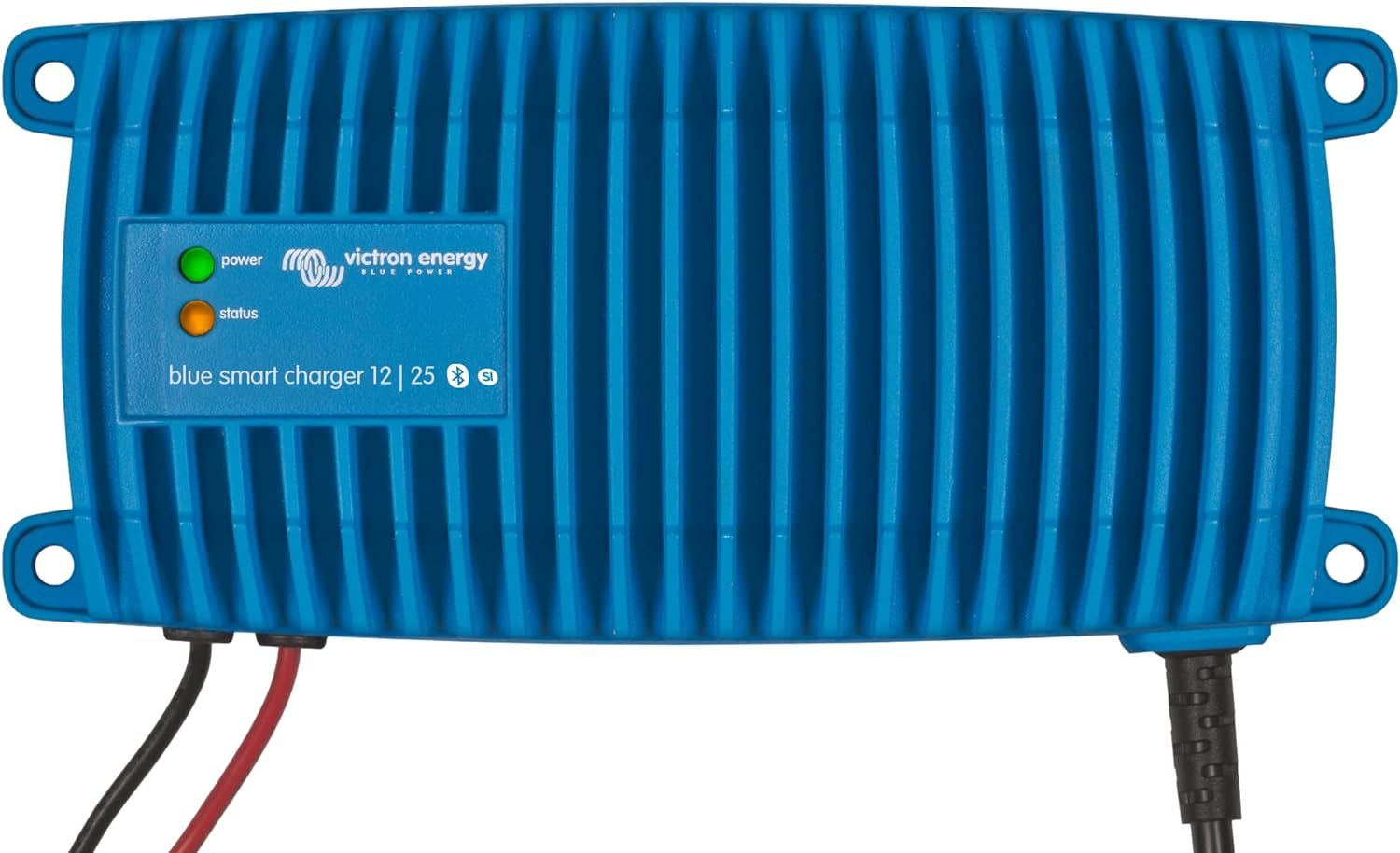

Victron also makes some inexpensive plug in chargers when you have AC power to the boat.
Victron Energy Blue Smart IP67 Smart Marine Battery Charger 12V 25A, Float & Trickle Charger and
