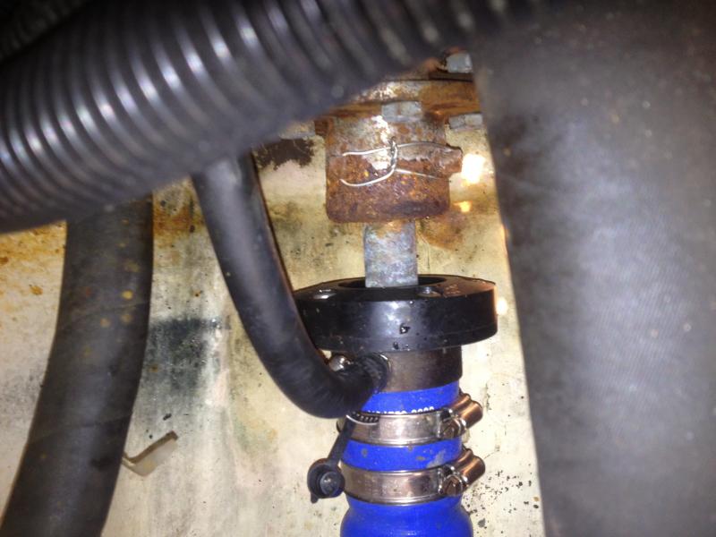

This winter I plan on tackling what started out last year being the replacement of the lip seal on my SureSeal dripless shaft seal. What should have be a $30, one hour project has, like most boat projects, turned into something much more!
Because of the small area between the SureSeal and the transmission coupling, a spare seal carrier was not able to be put on so I have to remove the shaft from the coupling which is very corroded.

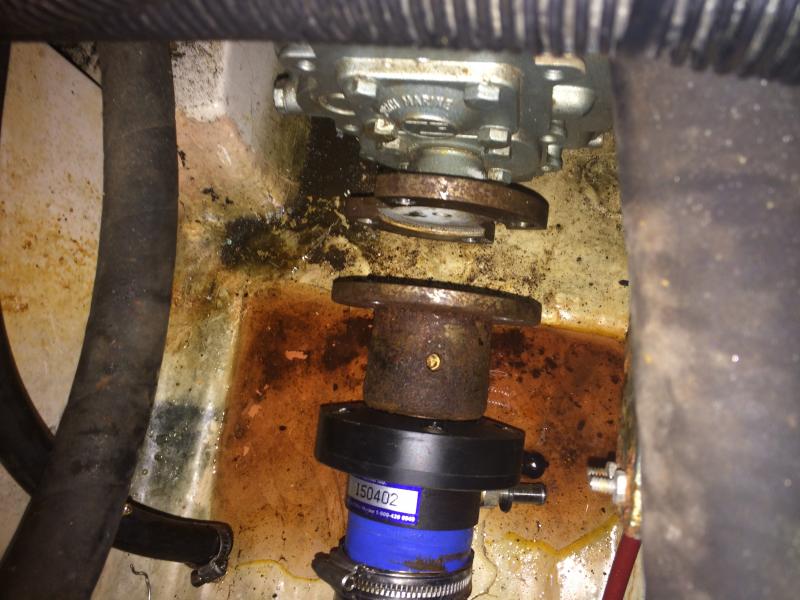

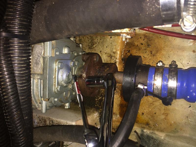

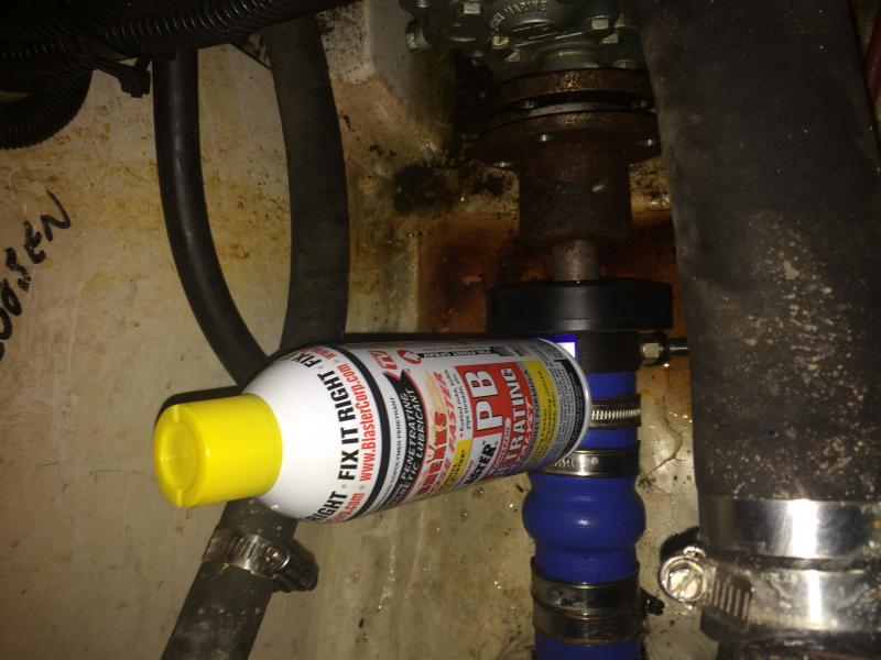

So, taking the advice in a previous thread, I PB blasted the corroded bolts once a week for four weeks and when I went to the boat yesterday, the bolts came off with barely any effort. The hardest part was keeping the open ended wrench on the nuts after it had fallen into the puddle of PB!
The coupling is off and the next step will be getting the coupling off of the shaft. Since there is no chance of damaging the transmission now, I'm going to attempt to salvage the shaft (just because) but will resort to cutting it if it becomes too much of an issue.
My plan is to replace the coupling with the Buck Algonquin Split Coupling, the shaft with an Aquamet and either reuse the SureSeal or look at the PSS dripless.
