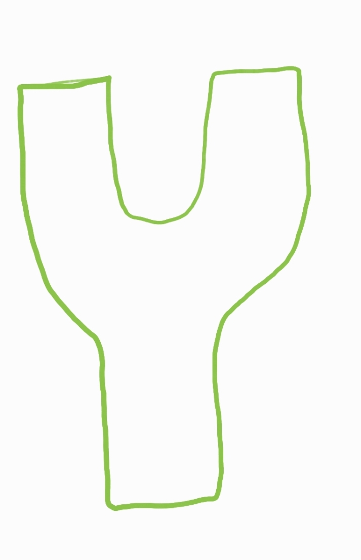

Anyone happen to have a Catalina 30 exhaust plumbing diagram?
I have a fork like fitting that fits the coolant lines. I don't remember where the 3 ends lead.

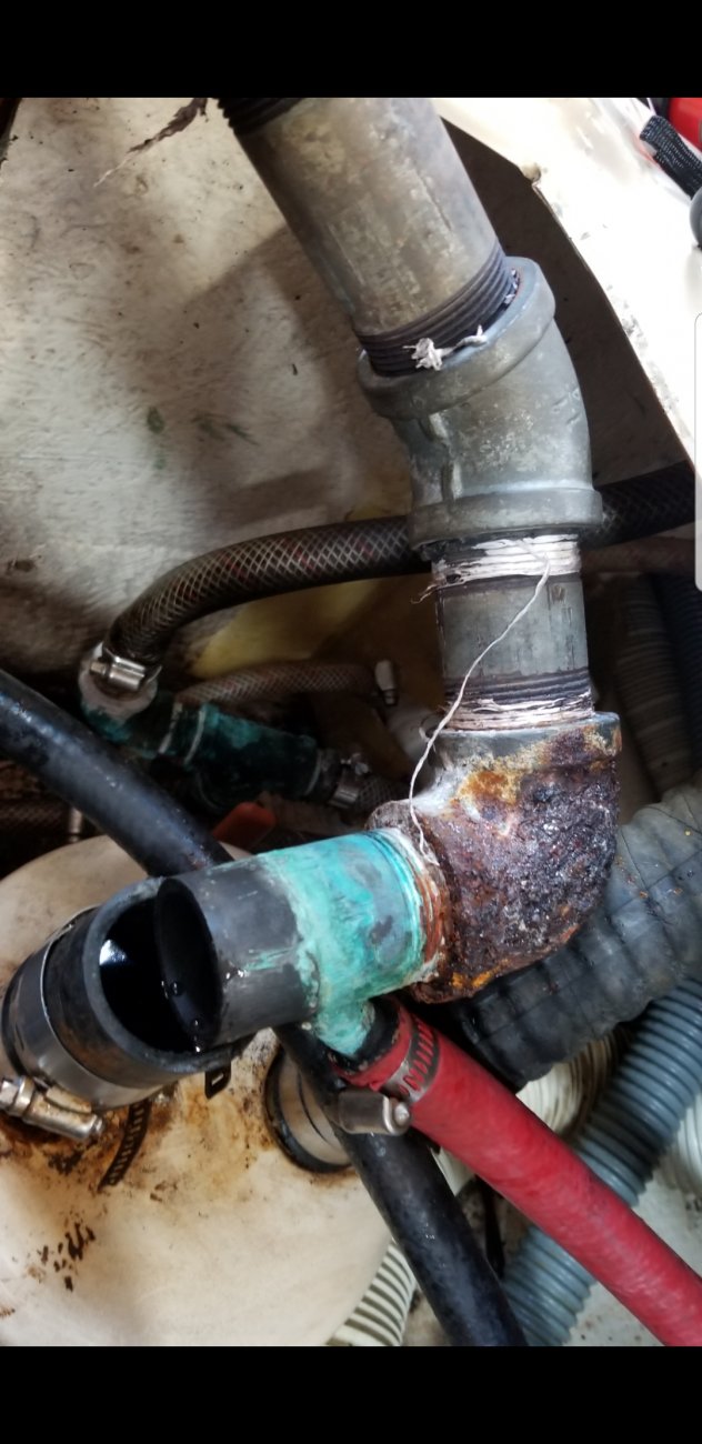

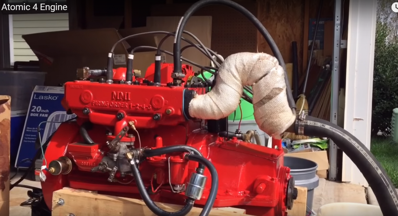

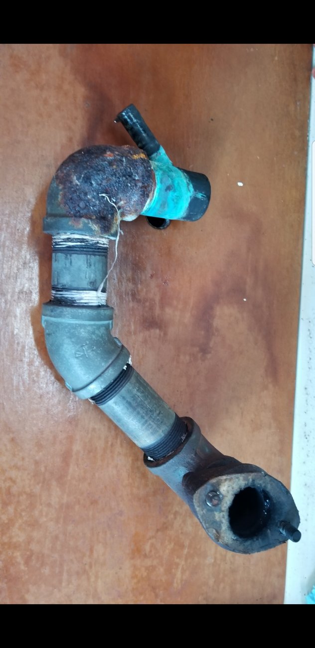

1. Notice the output of the HX goes right to the exhaust.
2. notice how high the exhaust elbow is set above the engine.
3. Notice only a bucket of water going to the water pump
