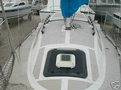

I looked at your hatch picture. You are one size too big. Get a West Marine or Defender and look up the measurements for the G966-1111 versus G965-1111!
Does your hatch have two arms? If yes, then you definitely have the bigger hatch.
As I said, my hatch from West Marine matched up all holes excet one was about a quarter inch off. And maybe that was not used on the original hatch. With the butyl tape mine is work well.
The reason I used the local West Marine was to let them do the shipping if it did not match up. Shipping is a PITA.
Again, mine is a Bomar without gasket. The Butyl tape is in effect making a gasket when you follow directions.
Yes, you can get a direct replacement that fits.

my hatch has two latch handles, but i think only one support arm. i have it repacked to can't check it easily.
I am waiting on a call back from rudy, he said he is talking to someone at bomar. he wants me to hold on to the hatch till he gets an answer. I was hoping to get another one on the way today..

I called Rudy today and they said that indeed the factory changed the specs w.o letting him know. It is true that the new size of that model is a little larger
They are going to give me a refund.
I decided to go with a bomar low profile N1000 series.It is alittle smaller flange, and I may get to play with epoxy a little if the screw holes are too close to the existing cut out, but I have a way of fixing that in mind if need be. It is a heavier hatch and hopefully if and when i step on it while dealing with the halyards my foot wil not go through it. Also If I am ever lucky enough to make it to salt water, but unlucky enough to get into rough seas, then it will not give way. Of course I know in that situation I would have alot of other things to worry about on this boat, but it seems that a big hole in my foredeck would be a really bad bad thing!

Solar Vent, that is what is in the middle. Looks like a Nicro brand (most are round, but that model was square).
