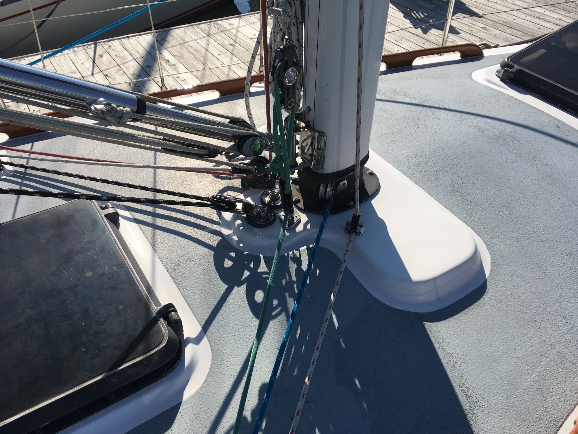

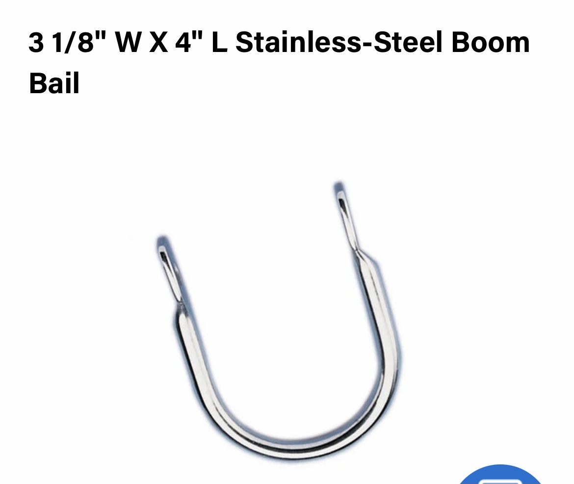

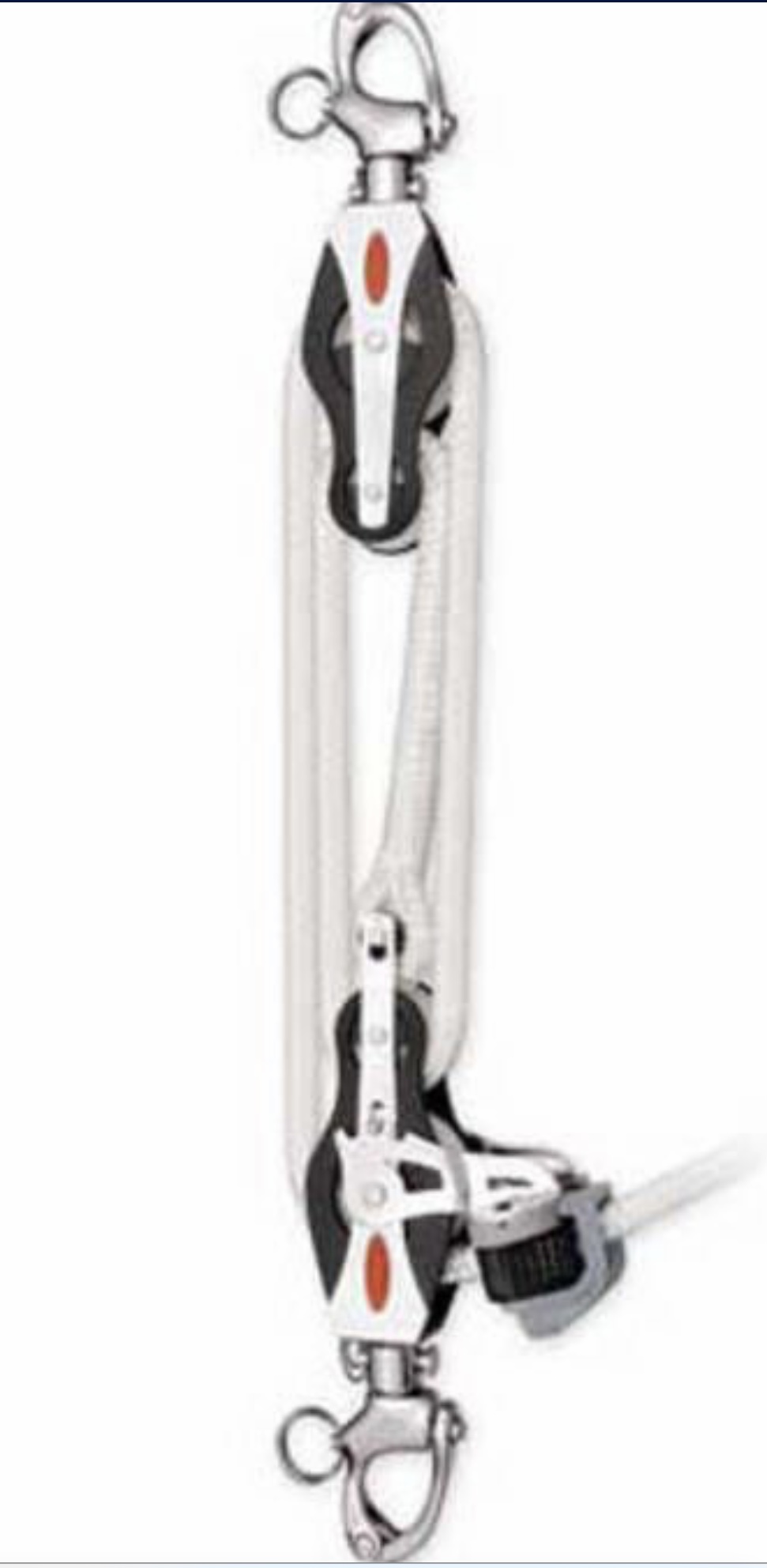

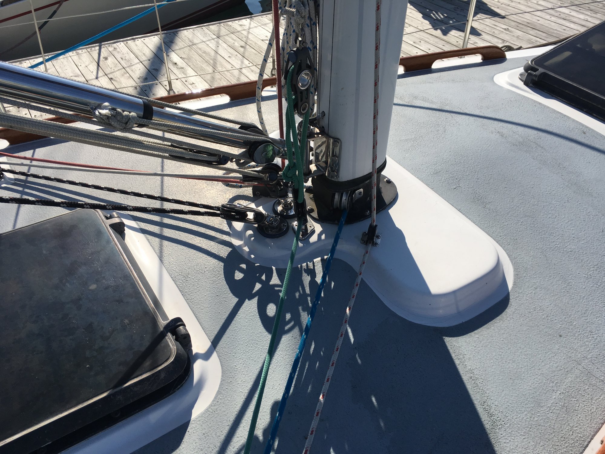

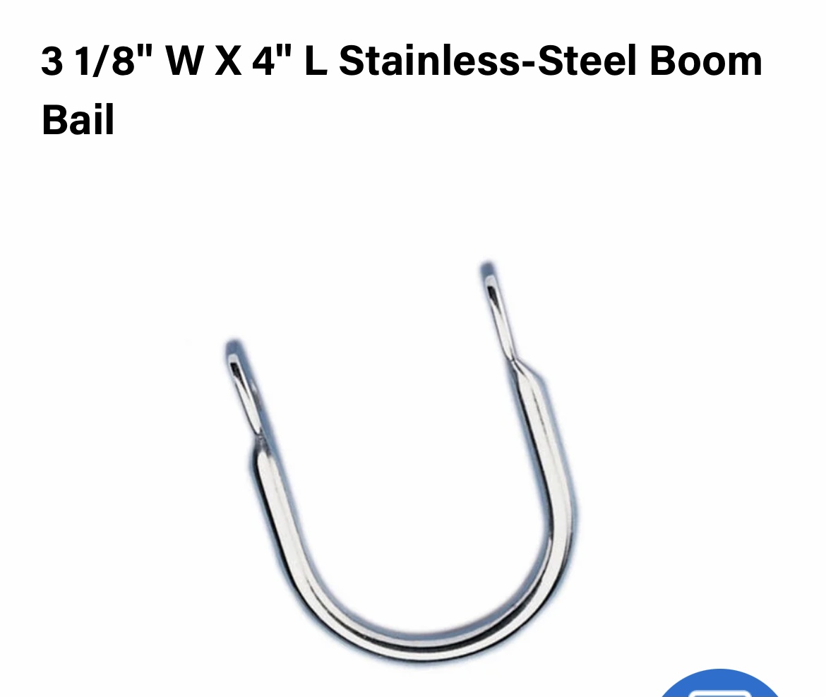

Welcome back @sandpiper10471 . I have a 1978 H30 with a simple vang setup consisting of a mast bail and a boom bail connected with a 4:1 double block system where the mast block has a cam cleat as the vang line lock. The images below show the vang on my boat and examples of the components installed.

Blow me away's vang looks like mine on our '77 h27. It works fine. But!
But you have to think through the mast step - the aluminum short pipe rising from the deck to hold the bottom of the mast. The hole I drilled to hold the vang bail rod as it goes through the mast went through the aluminum step inside the mast. So I have to remove the bail if I need to take the mast down to work on it! Not a big deal, but do think through how you want to do that.
