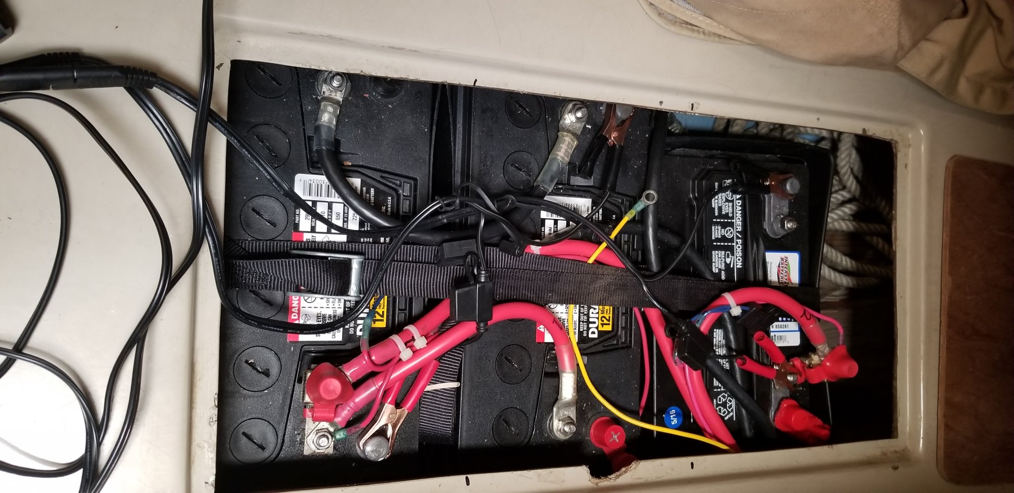

I have a house bank of two Group 29 Duracell batteries (120 AH each for a total of 240AH) and a Group 24 start battery (it's PLENTY of power) mounted under the aft quarterberth. I built a mounting platform out of G10 which I tabbed into the hull to keep them level and to provide support for the retaning straps. I love that I can check the electrolyte level without having to crawl into the lazerette, or open the door into the engine compartment. This also allowed me to mount the batteries so that they would be better positioned to keep the plates submerged in electrolyte when heeling. Each battery sits in a battery box, and is strapped down.
The picture below shows them disconnected from the boat's electrical system (and connected to a Battery Tender) for winter storage. There are covers over all of the positive terminals when the boat is commissioned.

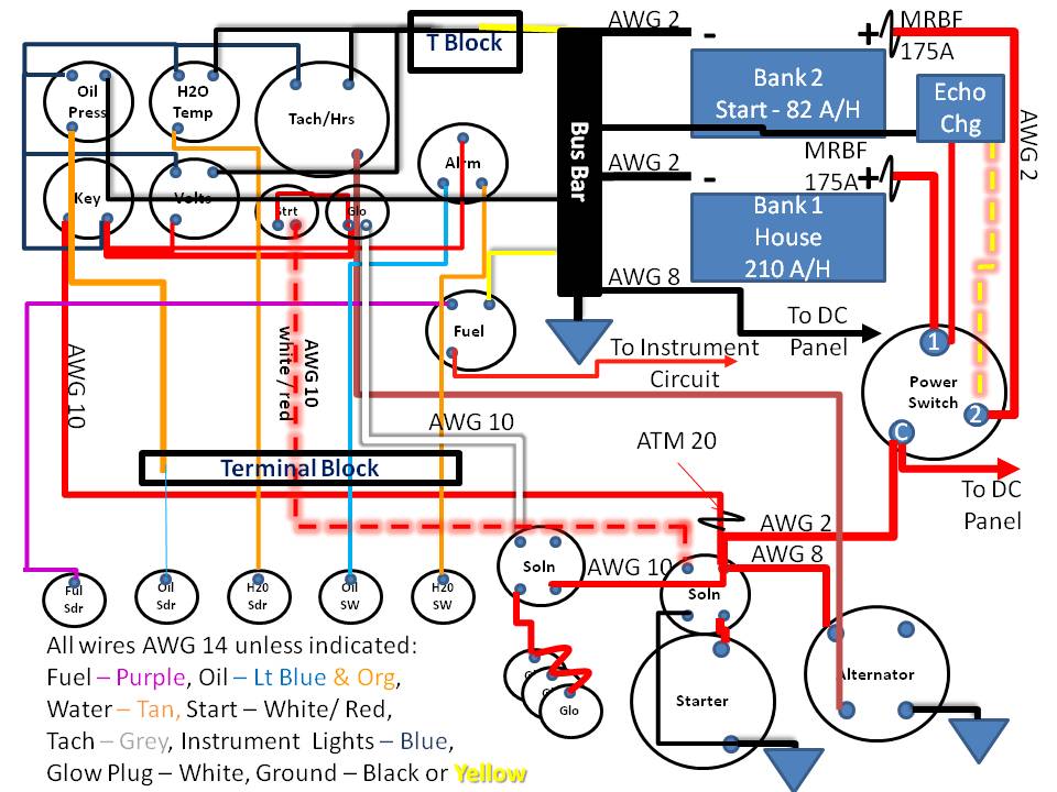

Many people that I have encountered seem confused by the "Start Battery" concept, or worse, have no idea what they are doing when they use the battery switch.
I explain that on my boat the start battery is used like the spare tire, I don't use it unless necessary. I normally start the engine and run all of my house loads (lighting, charging phones and small VHF radios, propane solenoid, 12VDC refrigerator) from the house bank. My start battery is automatically maintained by an echo charger, or when I switch the battery switch to "BOTH" when motoring.
I also maintain a schematic diagram of my 12 volt system as a living document that I keep aboard. Here is an older version as a JPG to give you an idea.

Thanks eherlihy, great diagram, that's basically what I want to do. My plan is to use the house bank like you say, only using the starter battery when the house bank is low.
