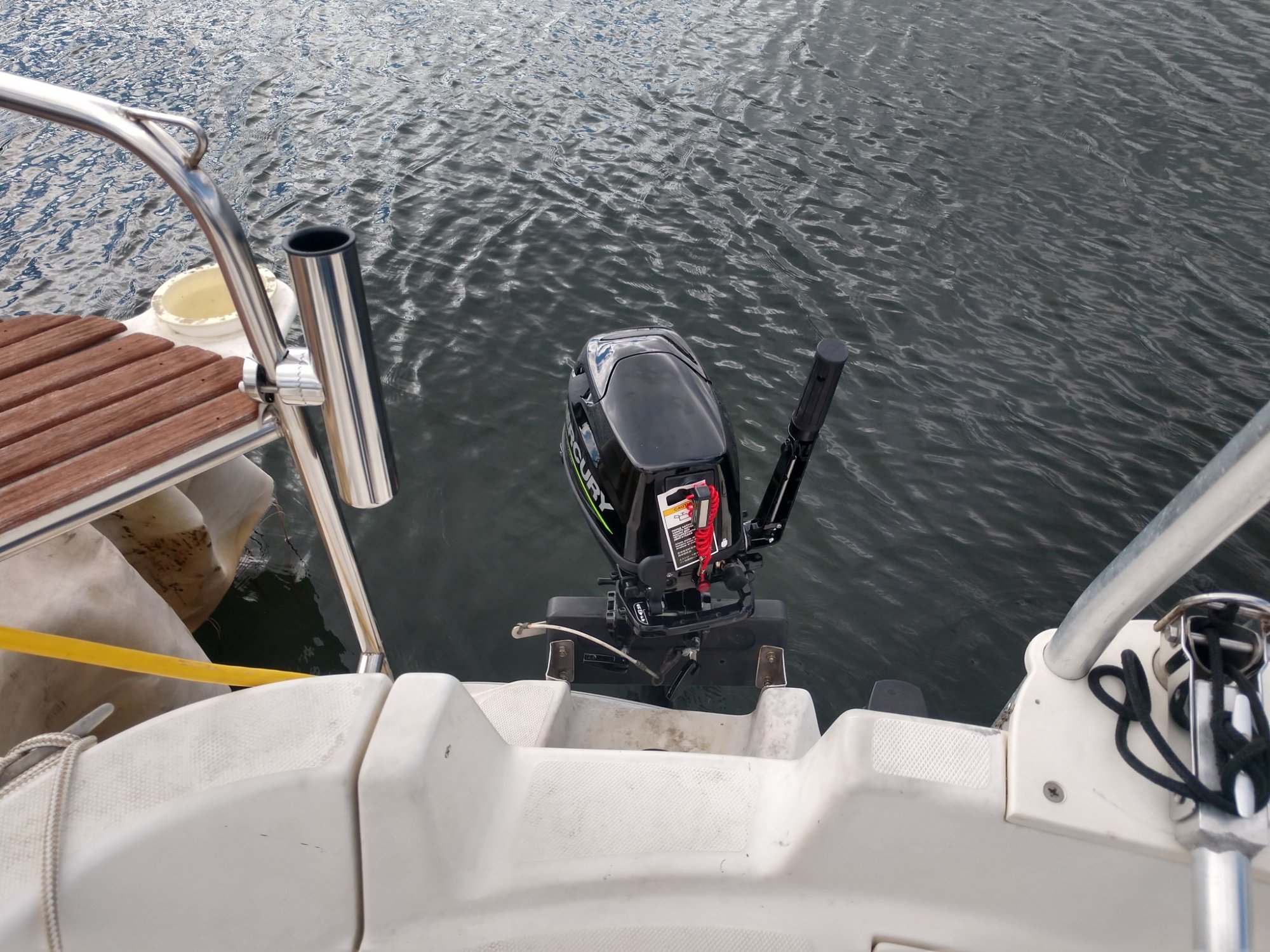

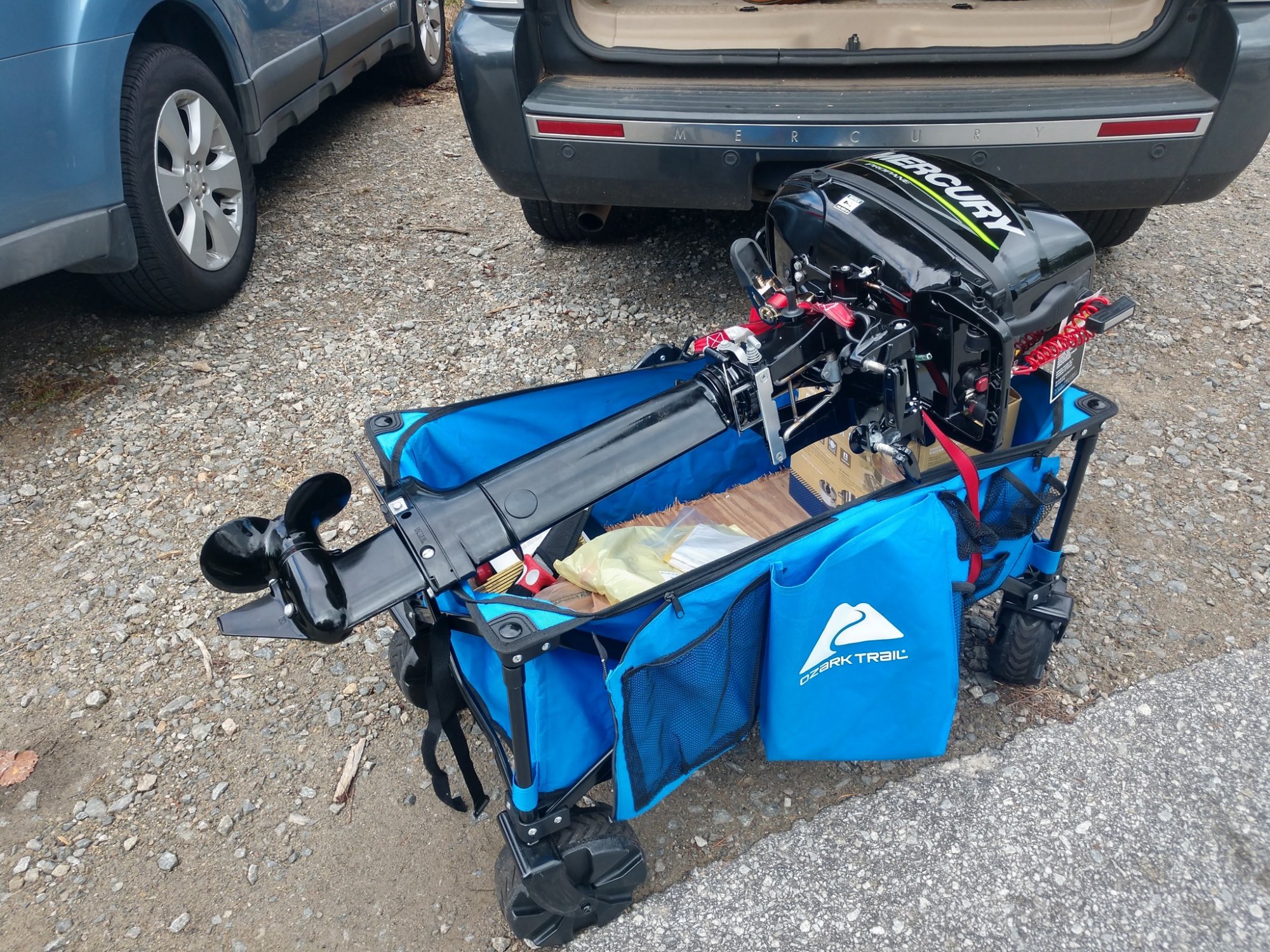

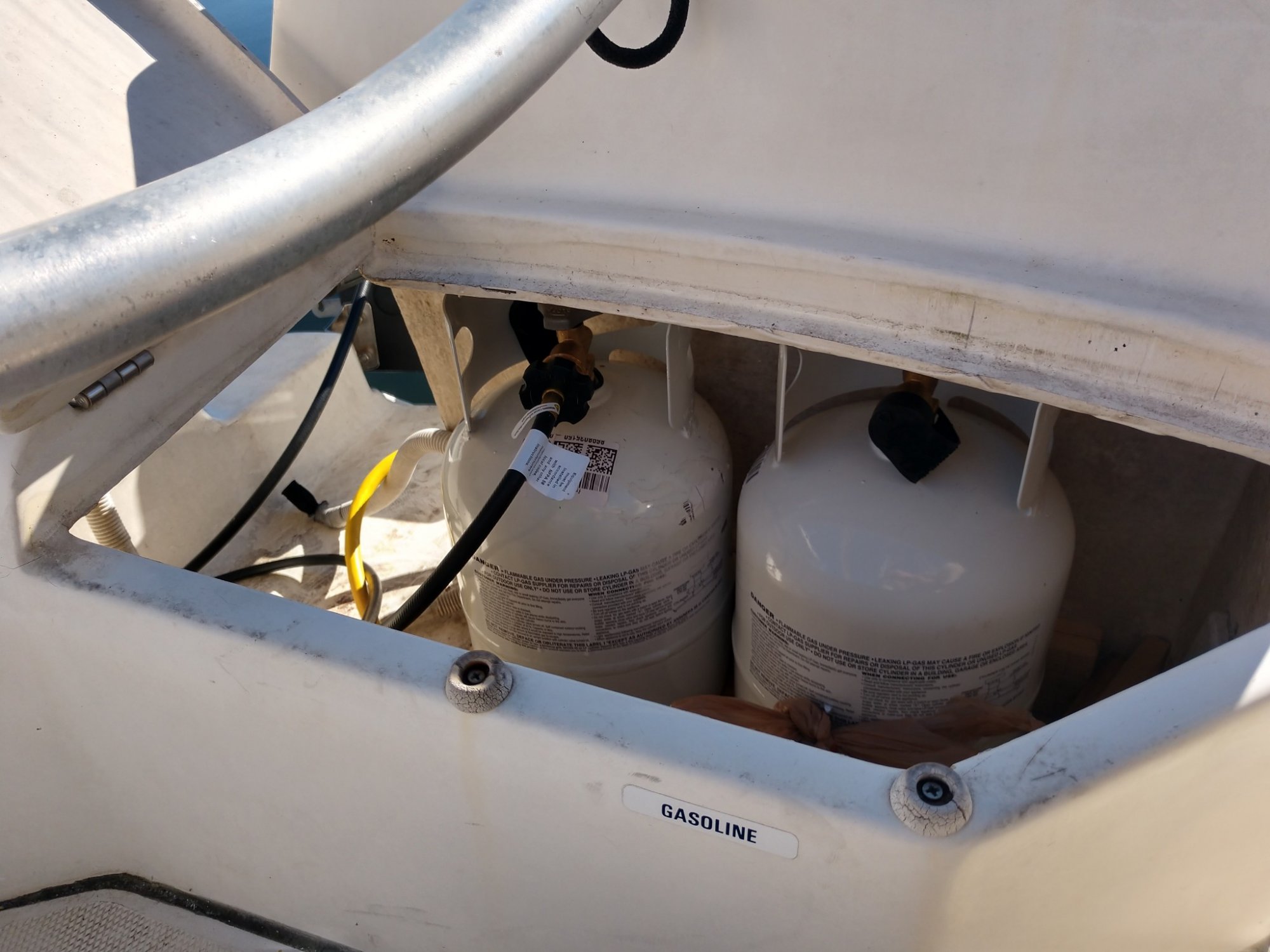

The Mercury works perfectly in my Hunter 240. It is forty pounds lighter than my Honda 8 hp. The eleven pound are the way to go.IMG_20211108_145841896_HDR.jpgMercury on Transom.jpgMercury on wagon.jpg
