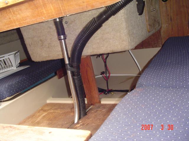

If the charging unit on your outboard is putting out, I would run a Marine duplex copper #10 wire red + and black - wire from the two contact screws on the side of the engine to a small terminal connector in your lazarett and have a separate duplex coming off the terminal to your marine battery. I installed crimp on eye connectors on the ends of the wires.
Depending on what kind of a load you are planning on having, a single 100 amp hour deep cycle battery should be enough for that boat. What I did was use the old eclectic receptacle on the inside transom of my boat for the wire to enter into the lazarett area. I took the plastic guts out of the receptacle and each spring when I mount my outboard to the stern bracket, I run the wire through the metal receptacle and add a bead of tape around the jacket so it doesn't pull out. Then I caulk around the wire to keep the water out. This task is pretty easy with an 8" Beckson Deck Plate in the center of the transom. I'm able to unscrew the cover and stick my hand in the opening to lead the wire around under the lazarett hatch. The two #10 copper conductors offer plenty of voltage and current carrying capacity for charging my battery. An electric Plug and receptacle has never been able to do that for me in the past. I use an electric autopilot most of the time and only use a VHF radio some of the time. My interior cabin lights are self contained triple A battery LEDs and I very seldom ever do any night sailing. That white wire in the picture is the duplex coming from the outboard charging unit. I mounted the terminal board on the bulkhead just inside the lazarett under the cover on the right side. I used a PC mouse pad to cover the electric connections. The other half of the duplex wire come into the cabin in that area to the battery under the cockpit behind that hose and pipe. The other outlet on the transom is for my Autohelm 1000 ST+ Autopilot.

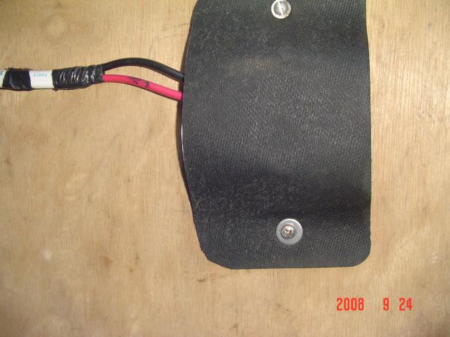

Second, I have a 7watt solar charger and have not yet hooked it up to my battery. Having read conflicting info about whether I need to regulate the charger, I am wondering if others are trickle charging their boats and at what point they would recommend using a regulator to prevent overcharging.

I honestly don't know much about solar chargers, but I don't think that a 7 watt collector is going to overcharge the battery. My friend Wayne mounted a small collector just to the right of his companionway on the cabin of his Seaward 22. He has a small air space under it so that it doesn't get too hot from the cabin roof. I don't think he has any kind of voltage regulator and he claims that his battery is always up with plenty of power. His 9.9 Johnson has electric start with a charging unit.
Years ago, I had to charge my battery at the dock about mid season every summer. I think that it was due to the fact that I was using a cheap marine two prong polarized plug and receptacle from West Marine. Now that I've gone to a larger copper conductor with a termination board, I no longer need to do that. The charging unit on the engine seems to be keeping my battery up the whole season. I never used my interior lights years back and if I did, it was for checking out a chart. I did use my running lights for hours at a time as I did a lot of night sailing to Potter's Cove in Prudence Island near Bristol, arriving in the wee hours of the morning. I no longer do that since I've been retired. If you have an 80 Amp hour battery, it's safe to say that you can get by with it if you just run the necessities like your VHF, running lights at night, and your autopilot. Hopefully someone else can chime in about solar collectors and what is needed.
