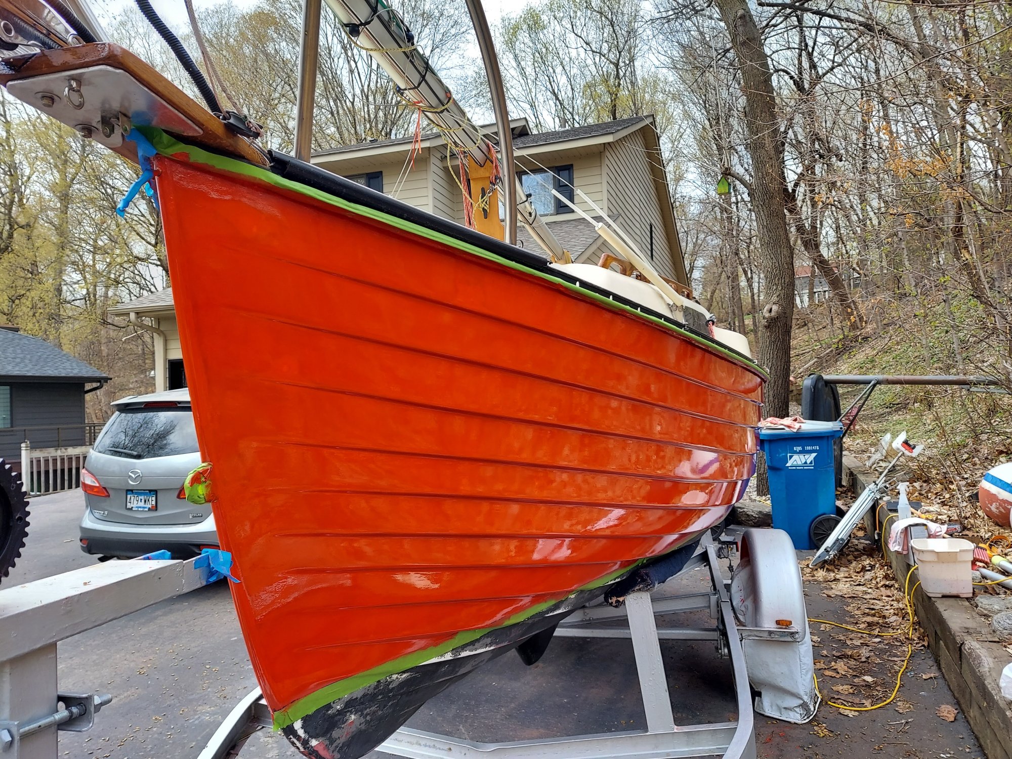

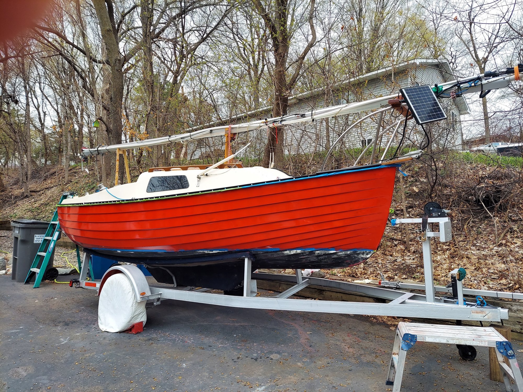

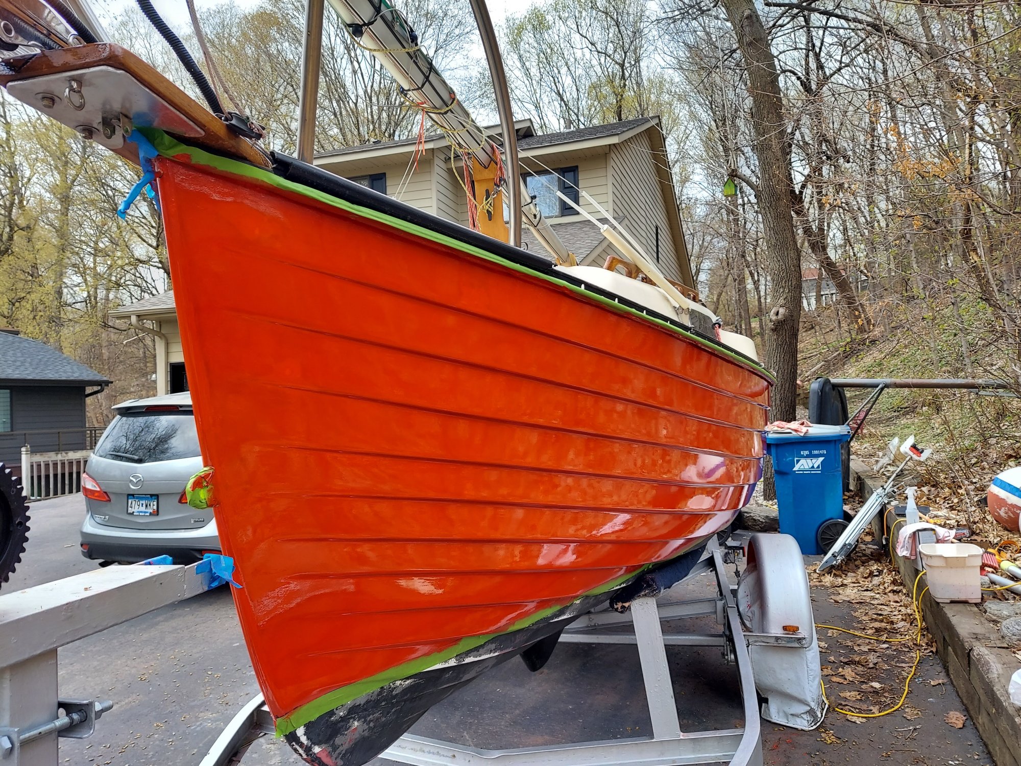

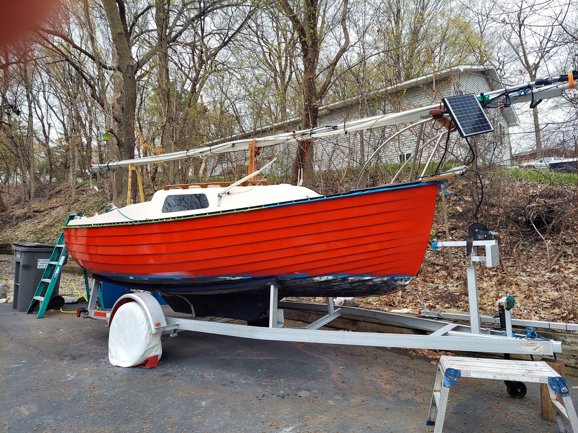

First coat of Interlux Perfection put on yesterday with a foam roller and not tipped.

I didn't do anything special but I think I (accidentally) discovered the secret to a near perfect application of Interlux Perfection: thin coats and cool temperatures. The minimum application temp is 50 degrees. It was 53 when I put it on. The cool temp gave the paint time to flow out and any bubbles to dissipate before setting up, without tipping. And the 2-part Perfection is a quality product. I just hope I don't mess it up when I do the next two coats this weekend.

I bet you're onto something there....it'd be interesting to do some testing on some random chunk of material. I'm most amazed because you're working on a sub-vertical surface. I've used Interlux (the one part stuff) before but it was a dead horizontal. Pretty fantastic stuff!
