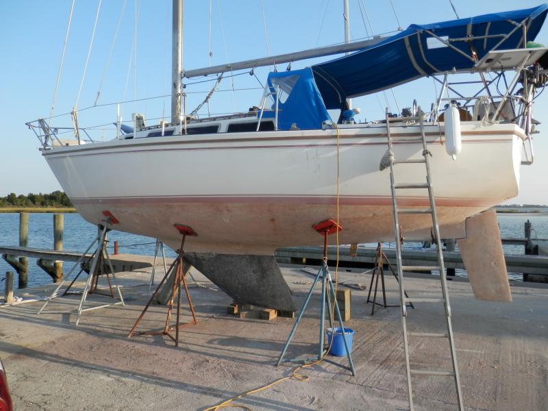

I own a 85' Catalina 30 standard rig with the fin keel drawing 5'-6". I am on the hard right now and am doing some extensive blister repair along with re glassing my keel joint and addressing my Catalina smile.
I am considering cutting 12" or less off the bottom of my keel to make it draw less. I was just wondering if anyone has done this with a C30 standard rig. I wouldn't consider it if I had the tall rig. I think I could with the smaller rig since the tall rig works with the same keel. I am wondering if that small amount of lead being thinner at the bottom would make that much difference in ballast and performance.

Not a good idea. Maybe you could find a shoal draft junker and swap keels.

Have you considered that the bottom 12" while thinner, is probably the MOST important part when heeled ? I wouldn't do it, think you'd have bought the boat if the PO had done it ?

Soundsd like a bad idea. One aspect is that the rudder draws less than the keel, which protects it in a grounding. You would lose that protection. The Catalina 30 is a stiff, steady boat. Messing with the keel might affect that righting moment. Do you really want to risk that? As others have said, it would affect resale, and possibly insurance coverage. Mostly, do you really need that shoal draft? I sailed my Catalina 30 for years in shallow areas of the South San Francisco Bay. If you really need less draft, it might be better to buy a boat with that built into the design.

Yeah I think most of you are right. I shouldn't mess with it. I did find a company and talked to them today, Mars Keel Technologies. They make keels for tons of production boats and custom ones too. They offer a solution using bulbs of lead attached to the bottom of the keel bolted through and faired out, equal to the weight that you cut off. They calculated that if I cut 12" off, that would be 12-1400 lbs. And at $3 a pound for the new lead bulbs, the cost would be outrageous. I thought it was a neat system though. I will leave well enough alone and stay in the deeper water. If anyone has a junk shoal draft laying around NC let me know. Thanks for all the posts guys...

Good Old Boat had an article about 10 years ago on this subject. Guy chopped off a foot of his keel and then bolted on to the remaining keel two lead sections from Mars Metal to form a bulb, gave him reduced draft with same ballast but not down as low as original. Try searching GOB for the article

I thought the bolt on bulbs were a good solution as well but pricey. If I could afford it and it appealed to the next B.O. if there is one, I would probably do it as long as performance wasn't and issue and could be proven. Then I would consider it an upgrade. And if that were the case it seems like most people would want it as well. Has anyone out there done this to their fin keel? If so I would love to hear how you like it.
