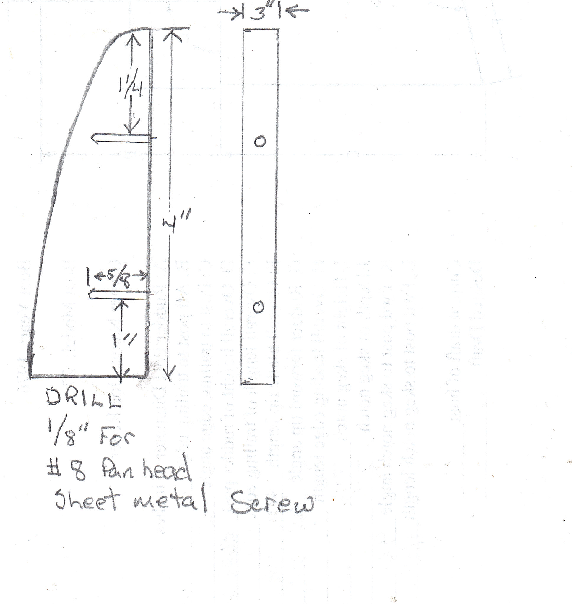

I used a 3/8 piece of nylon flat stock I had laying around. All it is, is essentially a third rib in the center of the rear bracket cut in the shape of the edge profile. I screwed it in with two #8 sheet metal screws in the upright edge. I can draw up a sketch later today if you would like.
I don't want to pester you about it, buuuut .... if you have nothing better to do, yes, I'd love to see your sketch. If you have time. Thanks!
I have no freaking life with YOT on the hard for the winter. Nothing but time until spring. Soooo, here ya go. You can call a local plastics house for nylon. They will probably have a chunk you can get for next to nothing. Don't use some of the more exotic stuff like delrin as it is expensive and brittle. If you can't get it locally check McMaster-Carr. It is also good to check local areas you plan to visit for their requirements on approved devices and their installation. That's why I called Transport Canada for a clarification of their requirements on the likelihood I will get a Passport and stop at some point. The thickness is 3/8" not 3". Sorry!
