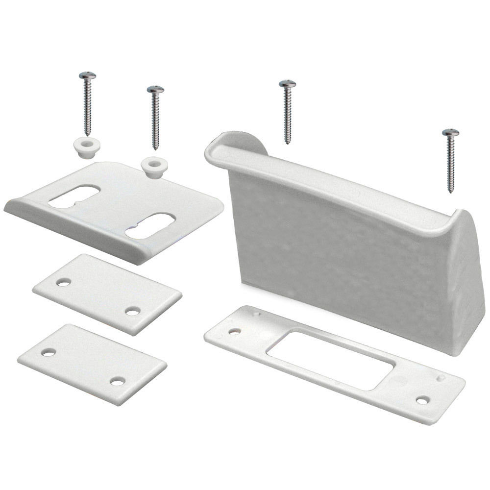

I'm getting ready to pull the trigger on one of these. It will be the self contained, non-MSD model, although for the sake of this discussion I don't think it makes a difference.
My question is in reference to the hold down kit, which is an optional extra with this model. Can anyone tell me how it works?? Is a screwdriver required to remove it for emptying? I'm looking at images of the potty, and I can't see how the deuce (LOL, accidental pun) the hold down kit actually works.
Any other miscellaneous info on the 550P is welcome. Thanks!

I did the exact same thing. The hold down kit is being redesigned since my conversation with them. No problem with the unit itself as it is the same as the MSD. The MSD part is the hold down kit. No tools are needed to remove for emptying. The problem with the hold down is the rear bracket will flex under load allowing the front to shift clear of the latch. I added an extra brace upright in the center to keep the rear bracket from flexing. No further problems. It is a nice unit overall.

Agreed that you may need some extra bracing for the securing it down part. I have the same, and while I do like the unit, I HAVE had it actually press back and forth to where it's actually come free and rolled all over. Now, that said, it's never leaked a drop, top or bottom. But it's unsettling, obviously. (I get some pretty fun rides on Ontario, so it's easy enough to get those waves and motion to do so). That's the first thing I'm doing on the checklist before going back in, is securing it better.
The way the hold down is designed to work, is that you would just press backwards on the assembly to flex the support so that the front "tab" of the hold down comes free, then lift the entire assembly. You'd have to pull the top off, set it aside, and then take the lower unit to empty it wherever. The problem, as mentioned above, is that it doesn't take much pressure to actually push it to release. so when you have it full of water, and/or waste, there's plenty of weight with motion force to do just that. Then it's all upside down from there.

I had the same issue until I added the brace to the rear hold down. It would flex allowing the forward slider to disengage and it would move fore and aft. I never had it move over the forward latch but it is indeed unsettling. I am also on Lake Ontario so hello to Little Sodus Bay. I called Transport Canada regarding the requirements of an MSD and the response I got was the unit is acceptable as long as it has the hold down kit. Again, I spoke to Thetford ( Laura Lancewicz) about the weakness of the rear bracket and she said she was turning it over to the engineering dept. for redesign and would contact me when they had arrived at a solution since I said I would buy the new model. That was 2 months ago so I don't know when the design change might occur.

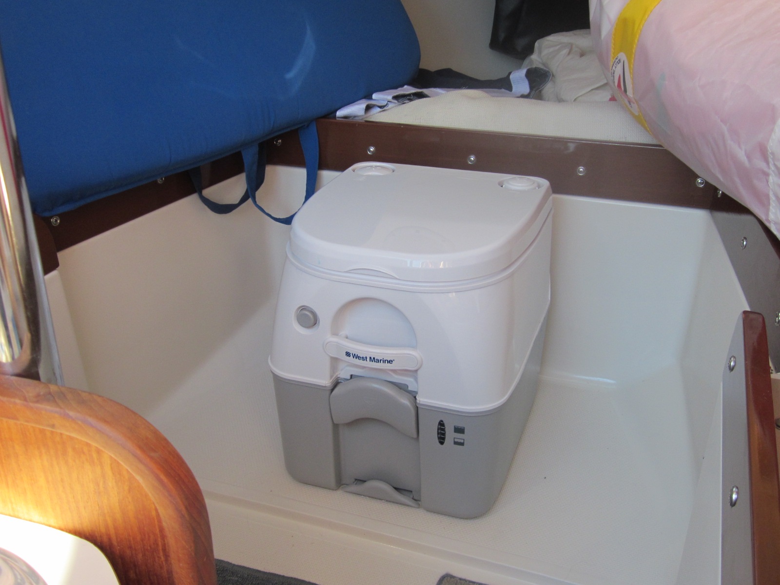

Gene,
I installed the West Marine version several years ago and like the extra holding capacity, but like already mentioned, when it's full, IT'S HEAVY! We like the extra height, more comfortable. Very easy to remove for dumping, no tools required, just pull that piece in the center on the bottom. The gauge started to leak earlier this year, after I guess 3 years of use, and some superglue cured that problem. But, we still miss the full marine set-up we had on our original C-22. Standard marine head with a 12 gallon bladder tank under the V-berth. Worked wonderful, and that's the way we'll go probably next year. Yes more expensive, but I'm tired of having to take the walk of shame.
Thanks, CharlzO! I finally found some pics where I could see the tiny little indent at the front bottom, and it all began to come clear to me. You confirmed it for me, thanks. I had been under the false impression that the mounts would go on the SIDES of the unit, since there is evidence that two different previous potties in the boat had mounts there.
25yearslater, can you describe the reinforcement you did? The potty is on the way, but I held off on the ($30!) mount, even before I saw all these great responses. It just seemed like robbery for what looks like, and evidently is, a $2 part. I thought I might fabricate my own, once I got a look at the unit, and I still may. I want it bomb proof. We stand our little Daydream on her ear now and then, and whether or not the unit could possibly leak, I do NOT want to hear fifty pounds of poop, water, and potty crashing around he cabin at the worst possible moment! :yikes:
I used a 3/8 piece of nylon flat stock I had laying around. All it is, is essentially a third rib in the center of the rear bracket cut in the shape of the edge profile. I screwed it in with two #8 sheet metal screws in the upright edge. I can draw up a sketch later today if you would like. Now when Ontario beats me like a step child at least I don't have to worry about the stuff hitting the fan.
