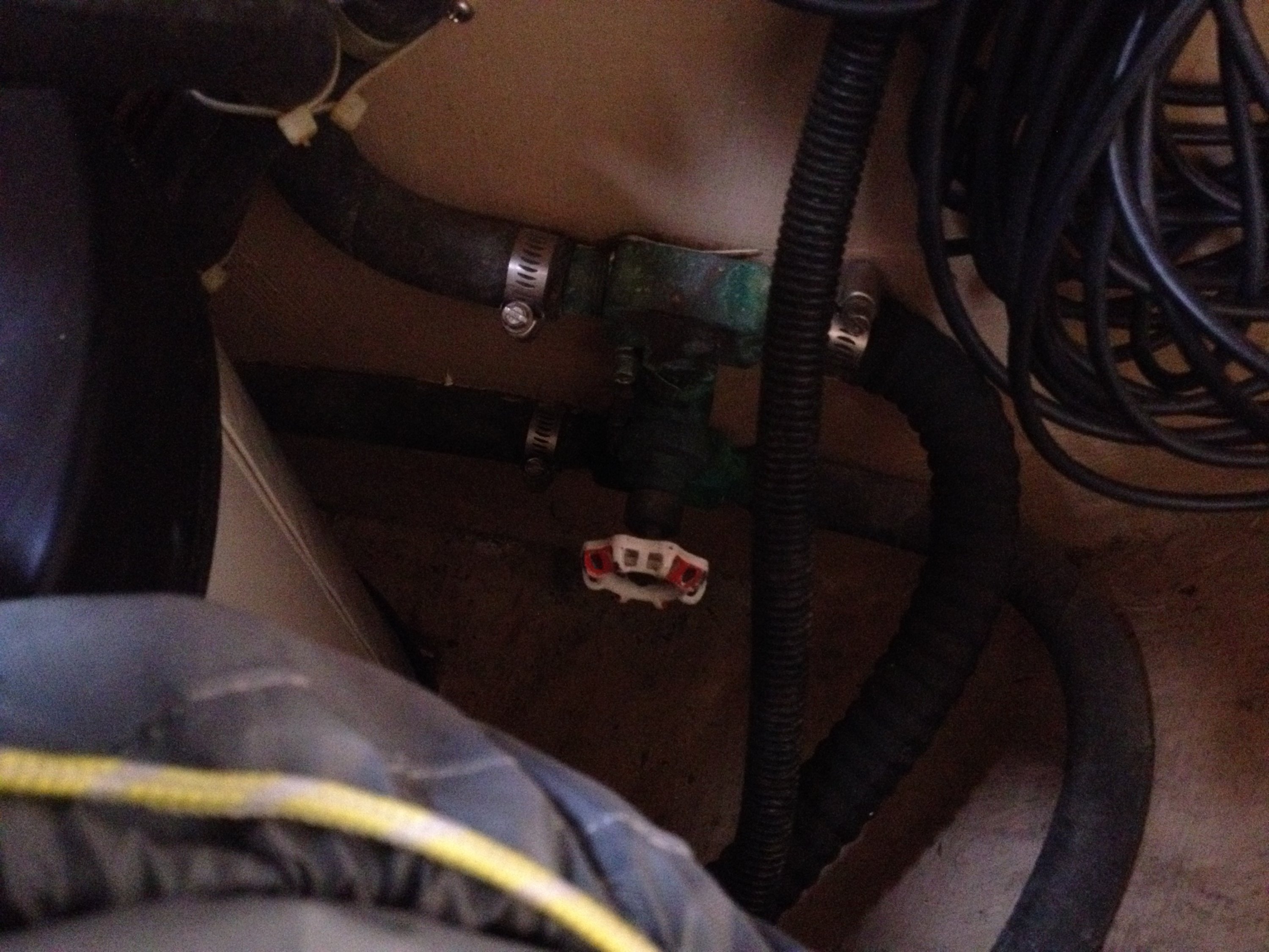

Side note:
There is coolant plumbing in the sail locker next to the water heater to allow a partial bypass of it. It's between the in and out hoses prior to the heater, with a gate valve. (Pic)
It's not directional, so I can only guess it's there in case the heater coil clogs. It's OE from Bristol.
When it's closed, the water in the heater heats up faster.
I leave it open, only to diminish the domestic water temp during normal outings. On long cruises the water eventually gets up to engine temp even with the valve open.
