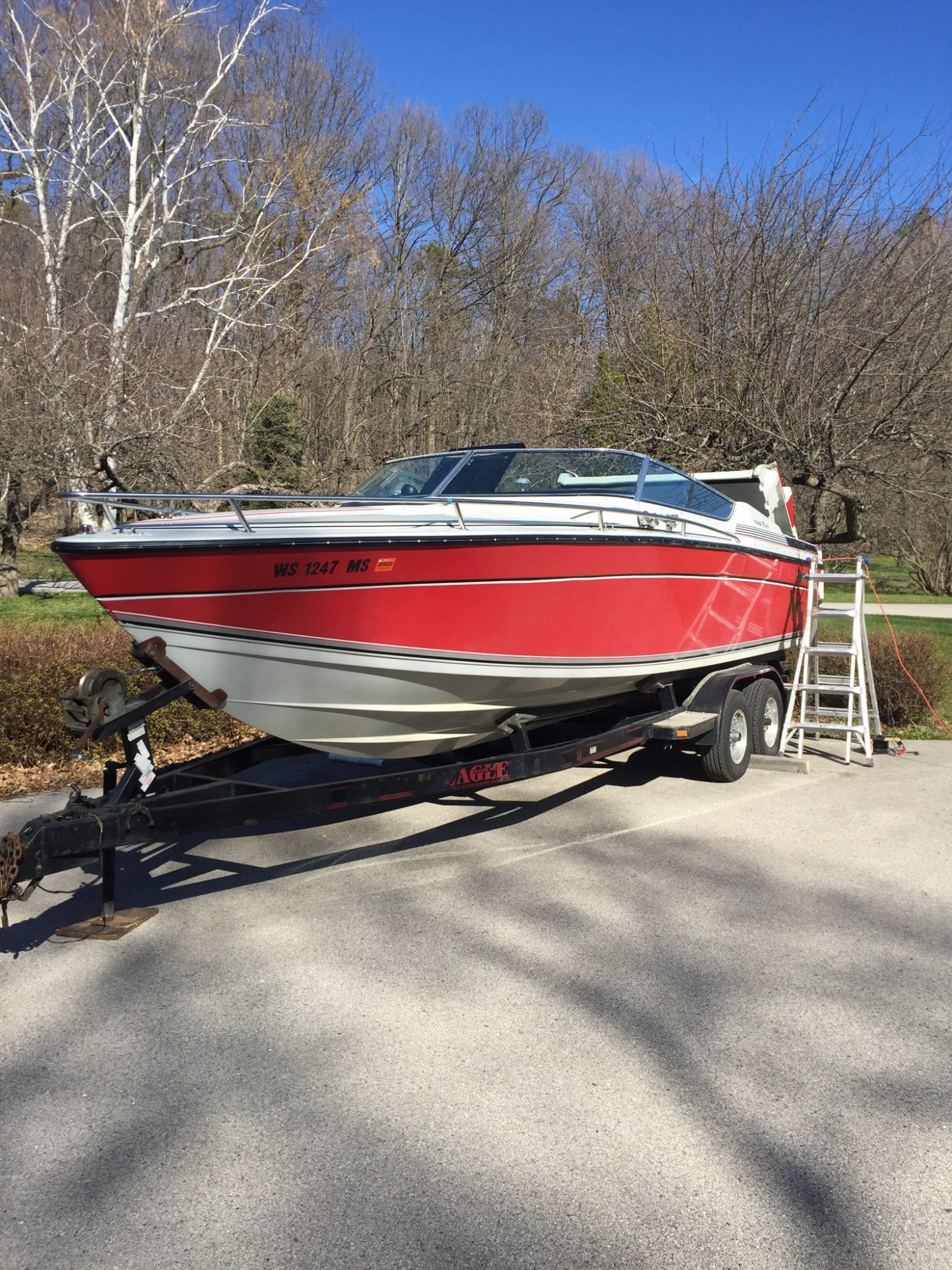

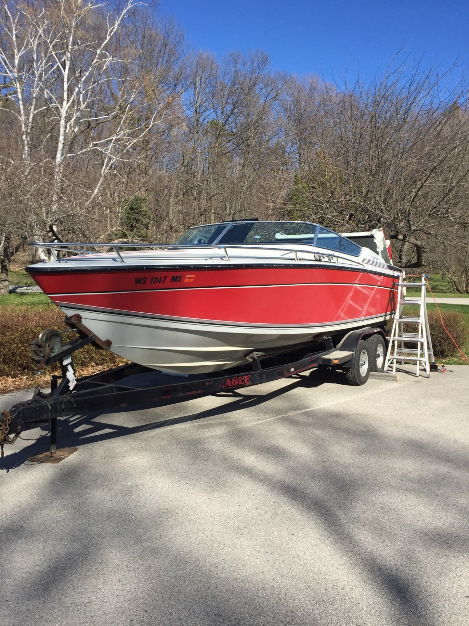

this is cherybomb
87' formula 242 ss, 454 rat block, cruise 38, top end 61, will plane at 19, bought it new back in the day, nice great lakes launch, still have it, runs great, when the lakes calm down it's a hoot. 3 gpm at cruise, ugly when you open the quads, have bimini and enclosure curtains, sleeps 2, eat up the street.
111 gallon tank,
and it's a great chase boat for the Ascow cause it can right it as needed.
and i have caoght a lot of fish with it. very safe on the big lake and the bay. windy and waves? it will get you home, but it's like thirty miles of bad road in an old one ton truck. the ramp is one mile from my house, aeoluse is docked down town, three miles from home.
