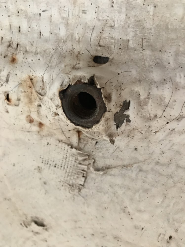

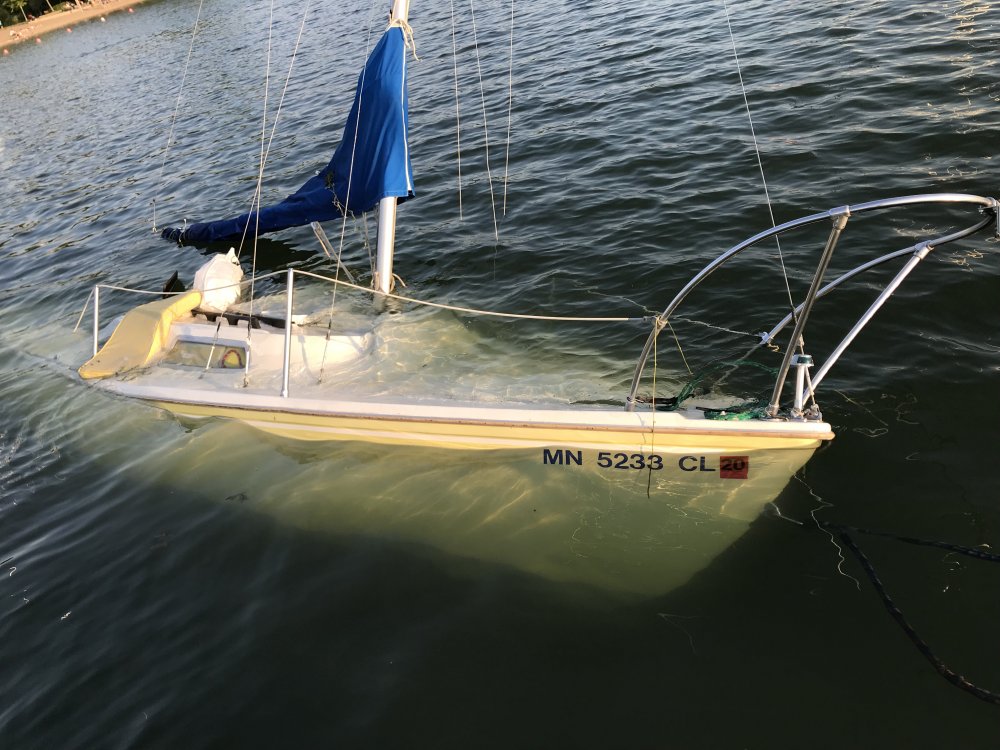

Yes the hatch boards are gone, but didn't break away as there was no damage to the frames and the latch ring is still in tact. After spending the day power washing inside and out. I discovered the Keel Locking Handle, was gone, thus leaving a hole that water could get in through. This may have been the way she went down. I have checked the shoreline and Craigs list. I just refinished them so I am going to go troll the out lakes to see if they ended up on someone else'sIMG_6939.jpeg IMG_6940-1.jpeg

I don't believe the locking pin is below the waterline but you may want to ask that question on the C22 forum as someone will know. Perhaps @Gene Neill as he has done quite a bit of work on his boat and sails it quite often. Have you tried floating it even without the mast to spot the leak?

I agree that the pin is above the water line. Putting her back "ON" not in the water tonight to check

Clogged scuppers? A similar boat near me sunk for that reason.

No brother, I actually have had worse calls too, but this one just sucked! Both scuppers clear and functioning as they should!

Does not the two cockpit drains of the C22 flow into a T-joint and then out the thru-hull on the bottom? A crack in the garden hose or crappy valve they used to use would soon sink you.

Keel lock handle above waterline. Mine drips at closehauled, but never docked.

I jumped to the end of this thread without reading anything in the middle. Your centerboard cable tube probably sunk your boat. It very nearly sunk my previous one. I had a 1970 Irwin 23 with a centerboard. The cable was raised and lowered by a plastic piston that traversed through what looked like a prop shaft stuffing box. One day I came to the dock and there was literally a foot of water in the boat above the cabin sole. I switched on the bilge pump and cleared the boat about a half hour later. After resealing the piston with lots of silicone lube I went to WM and bought a float switch for my bilge pump and installed it that day. It was pure dumb luck that my boat did not sink. If I did not visit it that day it absolutely would have. That is your culprit.
