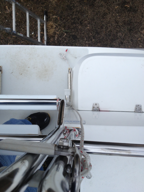

I simply added two lines (one to each latch) that extend down to the edge of the transom. A slight tug on each one releases the ladder and there's a third line that is primarily used for pulling the ladder up when on board, that is used to pull the ladder down. It's been tested (purposely) and it works well.This is a timely theme. I'm always surprised to see so many boats at my marina (600+boats) with their boarding ladders secured to the stern rail. It makes me wonder how the captains of those boats would get back aboard if they happened to fall into the drink while single handling alone.

Don't mind the dirty boat in the pic. I have to walk through mind and dirt to get to the ladder. Why won't spring get here???
