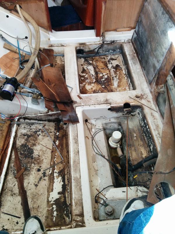

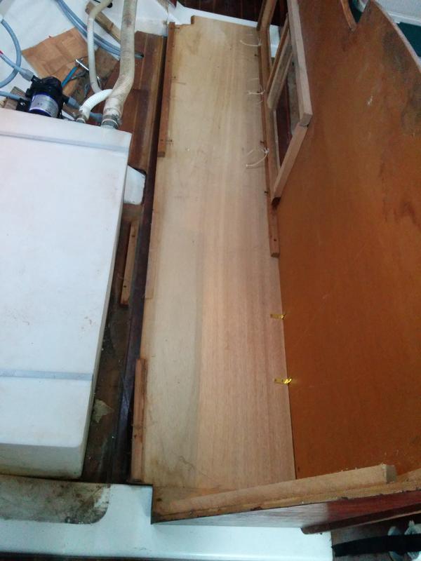

I replaced the salon floor this spring and to do so I had to remove all the settee's.

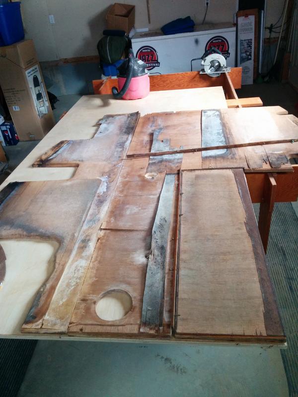

The floor is screwed down you should find dowels covering the screws. Mine came out in 2 pieces. But the biggest section wouldn't go though the companion way it was to wide. I had to trim it down it get it outside.
I've attached a couple of pictures one is the old floor on top of 3/4 inch plywood that I was tracing onto.
The second one shows the port settee removed and the water tank location.

I had rot under both the water tank on the port side and under the septic tank.

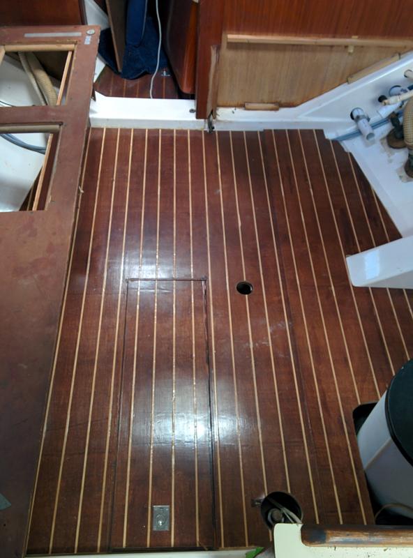

I used 3/4 inch birch plywood that I routed out 1/4 inch strips then stained. I then inlayed some light coloured strips and finished with varnish.
It's not a perfect match in colour but pretty close.
Like Claude I have 3 piece floor now instead of 2.

Very nice.
