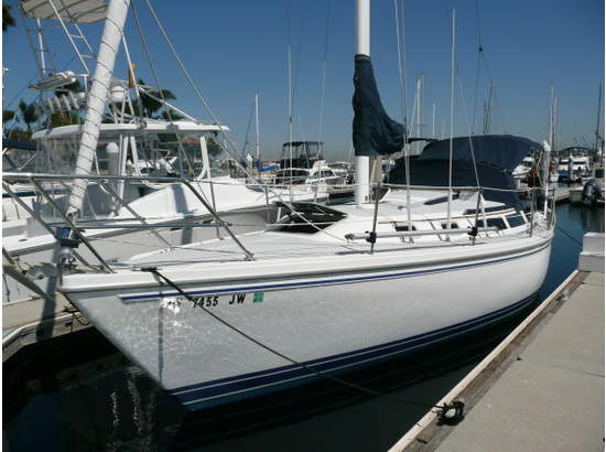

Hey everyone. I just purchased a SWEET 1992 Catalina30'. I was a Catalina owner in the past and had a 1980 Cat 27'.
Best upgrade I ever made. I am the happiest owner in the world. 1 Problem: the smell. Whenever I pump the head I am getting a nasty smell. The plumbing works, it seems to just be old nasty stench. What are my options and what is the solution?
Should I replace the holding take and pipes? Head? PLEASE HELP!

What a beauty! One of the nicest I've seen.
