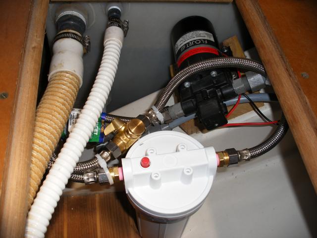

Installing a house-hold water filter is a piece of cake if you use the flexible connection hoses that you'll find in the Lowes plumbing section for making up connections to sinks, stainless covered and in various lengths. Here's what it looks like in my H34...

Not to turn this into a filter discussion but be careful where you locate it if you have a shore water connection as placing a filter on the pump output will not work there. Also,there are lots of different filter elements, many of which will only remove some taste and particulates.
